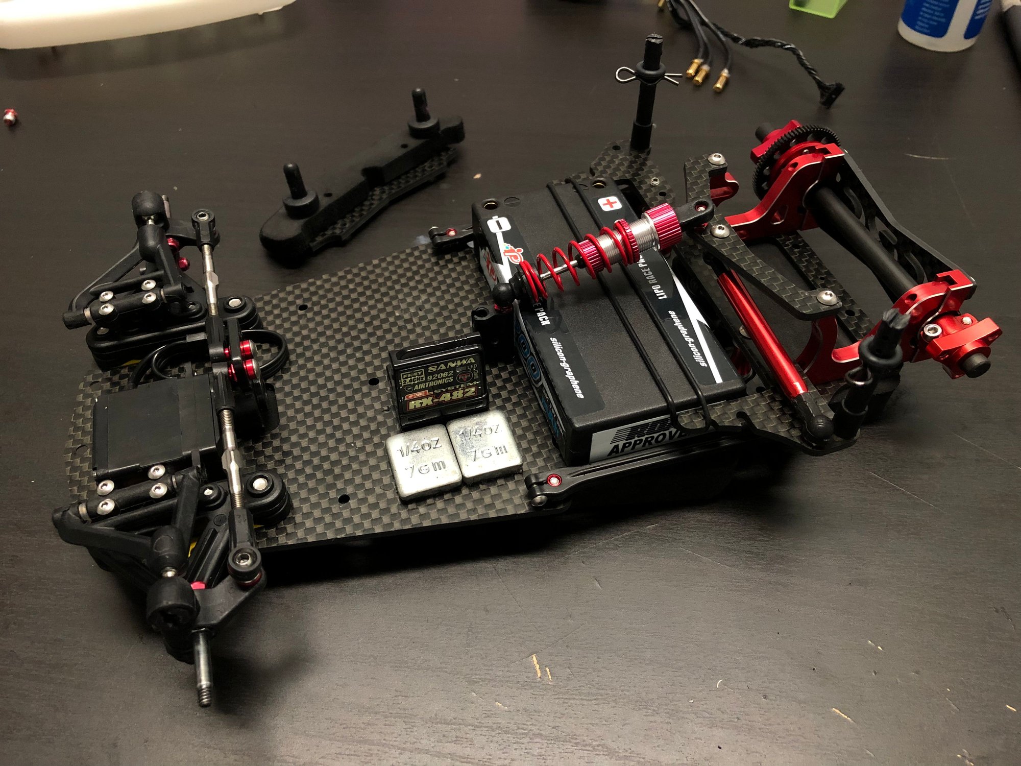

Giving the front mounted servo a try this weekend.
If I have the kingpin set to 10.2mm but have play between the e-clip and spring should I tighten it to remove it?
Also with 1 run one .50 and .45 springs one side has maybe .2mm more play than the other. Any ideas what is causing that?

Do you think you'll notice moving the servo forward 2 33/64"?

If the springs are slightly different height, you can make up the difference by shortening one kingpin. As for the play in the suspension you want to have a little play instead of any binding, make sure the front end moves absolutely free in both the top ball, kingpin slide, and movement of the pivot ball in the arm.
