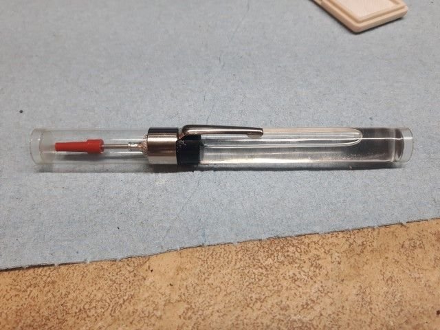

Does anyone know what weight oil comes in the kits? Is it 30?
I think it is 30 weight. I really appreciate that little needle-tip bottle they give you, yeah you have to keep it upright or it leaks but its still a nice piece.
Oh THAT's where it came from! Thanks DR, I couldn't for the life of me remember where that needle tip bottle came from or what was in it. Getting old...

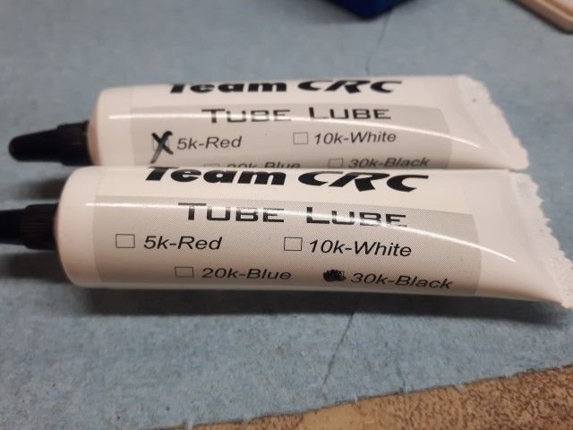

Kit also comes with 5k and 30k weight lube for the tubes. At least mine did.
