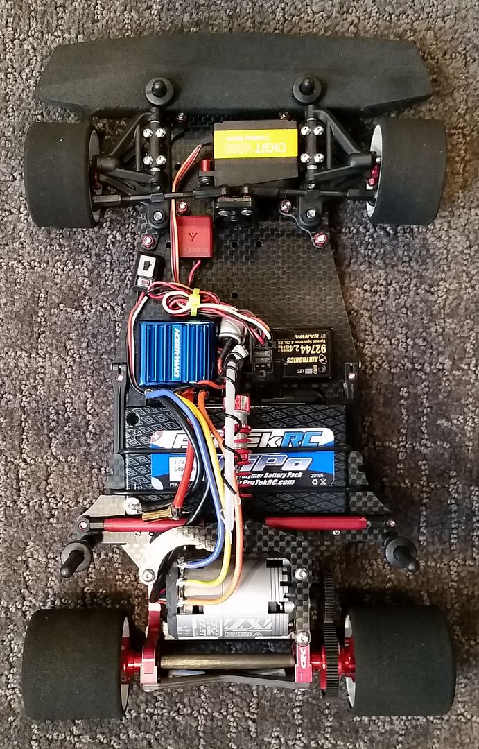

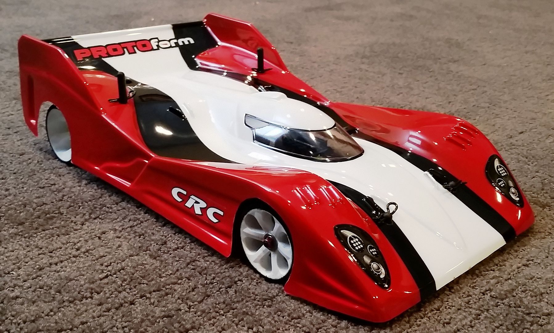

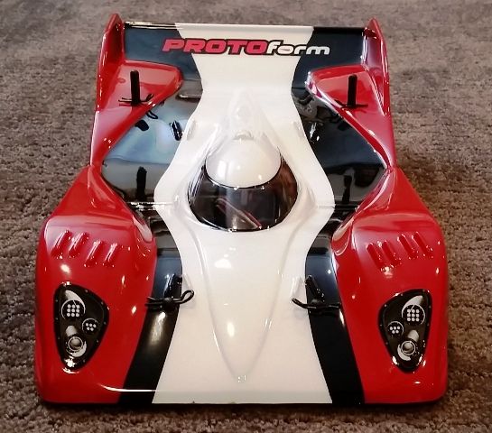

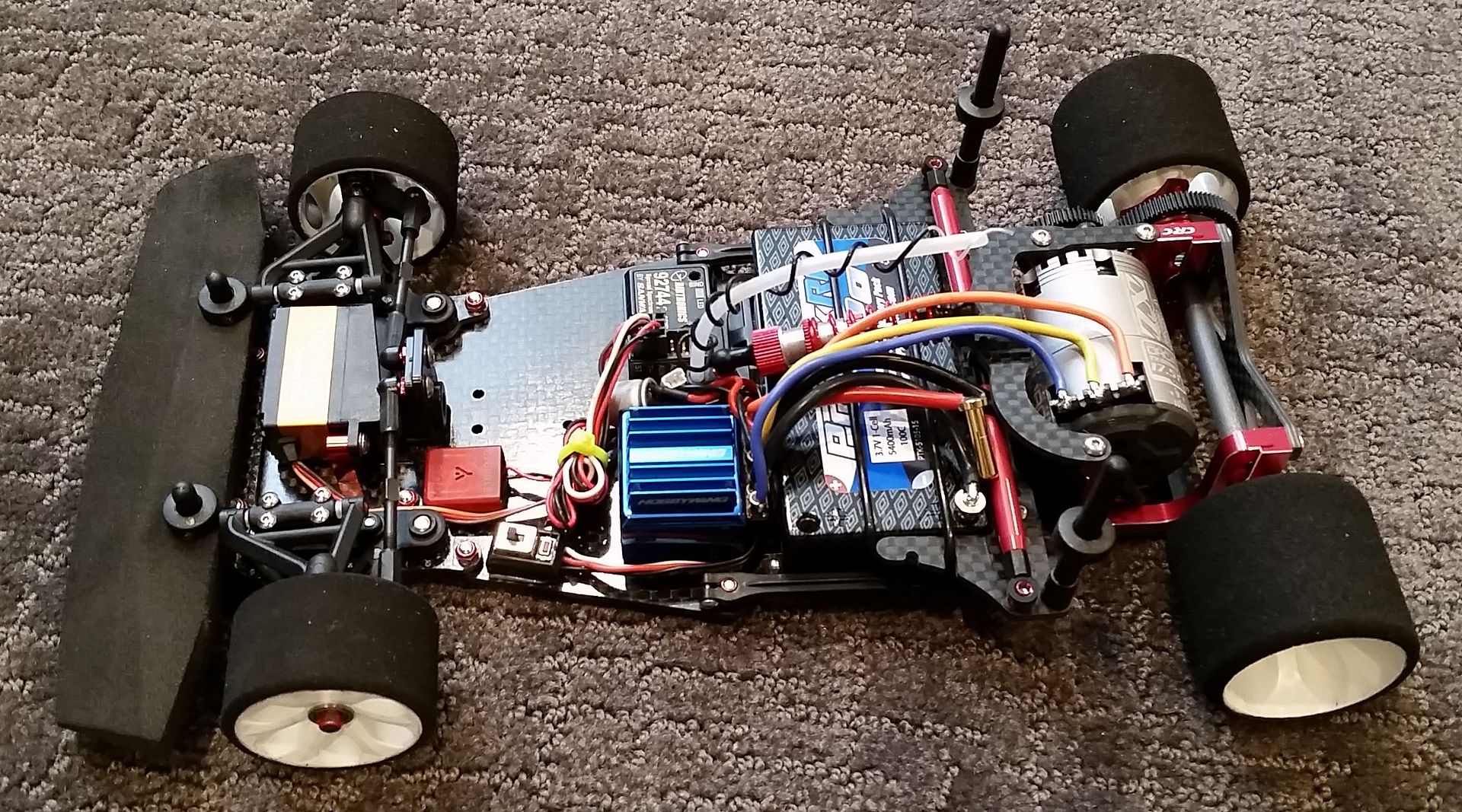

Just wanted to say thanks to all the guys on here who helped me out with my first 1/12 scale car. Just competed in the Utah Carpet State Champs Race with it. The XTI-WC was great all day. I only had one small problem with one of the damper tubes coming unthreaded and grinding itself on the pinion gear. I ended up with this setup:
Motor: 17.5 ORCA TX (Timed a couple notches above 10', temped about 130)
Servo: Savox SH1250MG
Battery: Protek 5400mah 100C
ESC: Hobbywing Justock 2s (yes 2s no battery)
Body: Protoform Strakka
Diff: Tight (I thought it would break in a bit more than it did)
Gearing 80/59
Rear Tires: Jaco Yellow started at 43 ended at about 42.5
Front Tires: Jaco Black started at 42 ended at about 41.5
Ride Height: 4.5mm all around to start (was as low as I could go with parts I had, track rules was 4)
Camber: 0 degrees
Caster Block: 5'
Toe: 0-.5mm out
Front Springs: .50mm (Kit Included)
Front Droop: Maybe .5 (Not much)
Pod Droop: ?? not sure but pod dropped a lot. Built shock with no O ring under piston because none was suggested in the instructions.
Shock Oil: Kit included not sure what it is
Center Spring: Red
Side Springs: .50mm (Kit Inlcluded) Just touching
Side Damper Lube: 5k (Kit Included)
Like I said the car was great right out of the box so to say. I just built it as the kit specified. Then adjusted for about 0 on everything to start. The only ill effect I could say was that the car tended to want to go right on accelleration. I assume this was the diff being a little too tight but one of the more experience racers said it could be the grain of the carpet as it only happened in certain areas. I have already got some option parts for adjusting the ride height and the front camber gain as well as some smaller gearing both pinions and spurs. I intend on trying different tires and gearing next time I can get the car out to race.
This is what the car ended up looking like inside and out.
And the end result was this:

Russ, you didn't include in your write up that you won! Congrats!
One little trick I do when I build tubes: motor spray out the tube & threaded stud, then CA it in place. That way you thread your tube into the ball cup and it stays put.
Pod droop gets explained many ways. If you set your chassis on 10mm blocks and you measure at the rear pod 8.5 or 9 (or 1 to 1.5mm less then 10), you are ideal. If you have a bumpy track, letting the pod drop further can help. If you have a smooth track and the car needs to rotate more, you can run less. There are far more effects to discuss on pod droop, but that is the #101 class.

Another thing to keep in mind is when you use Jaco tires, they have more offset. So you need to widen the car to get the width back.

Thanks! I will try setting the pod droop better. I'm sure its more than 3-4mm now. I remember reading about putting the second o-ring that came with the kit under the shock piston. I'll try that and re-measure.

Thank you. I have not heard that before. How do I widen the car? I have two small shims behind the front tires but I don't think they even add .5mm. I don't think much more would fit and still get the wheel nut on. How do you widen the back? I did notice that all the tires fit under the body pretty good but I still made the wheel openings big enough to hopefully not get body tucks should I get hit. Luckily nobody caught up to me

You will notice that in the center of the rear pod plate there is a tiny hole. This is used to measure distance to each tire From the center line (I normally measure to the inside of each tire from this hole with a digital caliper). These measurements are super crucial and I can't tell you how many times I see this off on racers cars. This will tell you if the tires are evenly spaced from the center line on the car. Once you have that perfect(by adding axle shims to the side that is short). You can now start to widen the car in even increments with the same rear axle shims you used to space the wheels. Typically you will widen the car to between 171 mm and 172 mm. This will get you to maximum legal width which is where you will normally keep it. Hope this makes sense....

Ya the balance hole right? I used it and the front one to balance the car as best I could. That's why the transponder and wire bundle are pushed off to the left. Do you know what shims I need for the axle? Is there a CRC part number? Is it the 4732 1/4" shims?
I'll measure it tonight as I remove the aluminum ride height shims from the front end plate and install the ride height adjusters. I read somewhere that the 2 degree roll center adjuster is good to add also so I bought one.

Yep. That's the shim set. The roll centers are a good option part to have on hand for sure. I seem to only use them on high bite though but they are a must to have when you get in that setting IMO.
Here's a tuning guide that I forward to guys that helps out a lot with different situations if you travel from track to track. Hope it helps.
