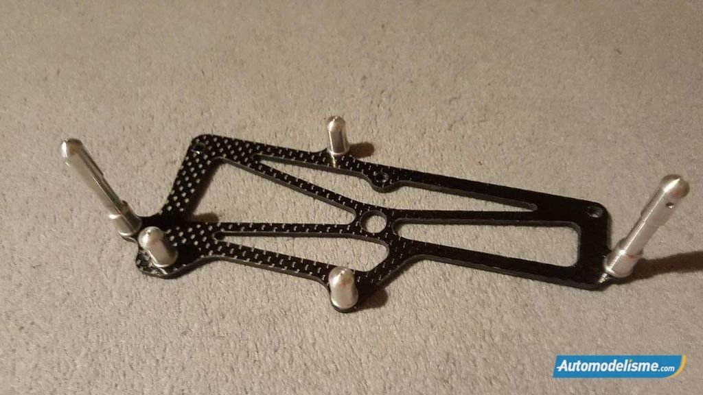

I ran for past weeks this option and it works great!!!
It replace the carbon fiber plate and gives good flex.
That improves steering and driving is very smooth.

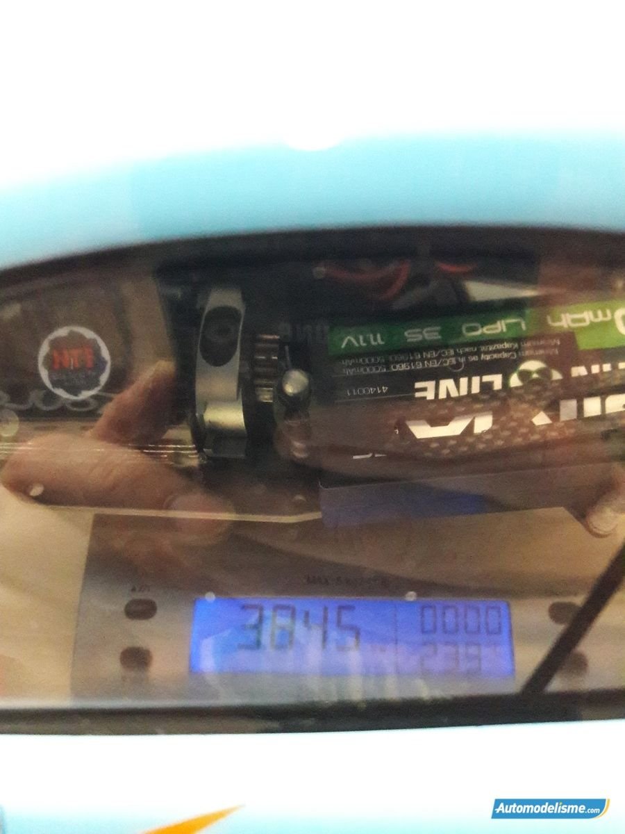

My Cobra GTe 3.1 optionned with all lightweight parts....
3845g ready to race!!!

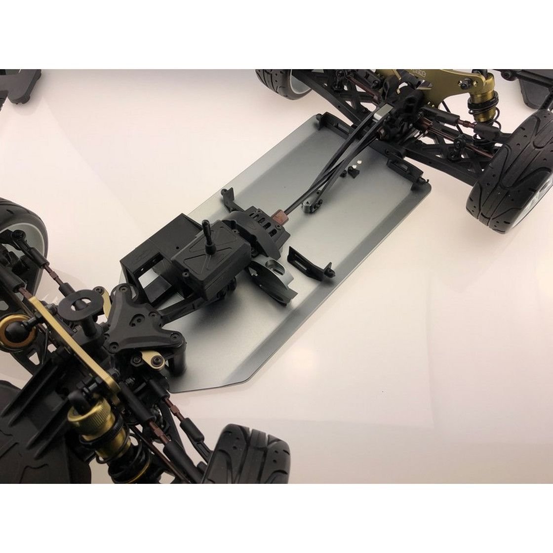

The new 2018 Cobra GTe 3.1 is here with a lot of improvments!!
- 3.1 geometry (front alu 6 C-hub, rear alu upright, redesigned alu lever....)
- solid center axle
- new spiral ring gear and pignon with standart driveshafts
- silver front and black rear springs
- 2.3mm front and 2.7mm rear anti roll bar
- hard servo saver spring
Serpent Model Racing Cars - Product - Serpent Cobra GT 3.1 1/8 EP

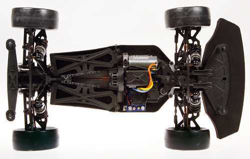

My car is a SWB.
Here's a picture of a standard SWB kit .
And the LWB kit.
romuald31 is offline
