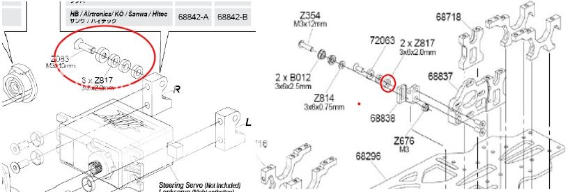

Has anyone else noticed that with 3 x Z817 washers on the front battery stop and 2 x Z817 washers on the back battery stop, the battery sticks out further at the back?
I had to remove 1 of the washers on the motor mount battery stop at the rear so the battery runs parallel to the chassis.
dvaid852456 is offline
Old 12-05-2012, 06:39 AM
  #548
Dog Bone's Avatar
Join Date: Aug 2009
Location: Calgary, AB
Posts: 1,425
Yup, you're right. I did the same thing to get the battery parallel to the chassis.
