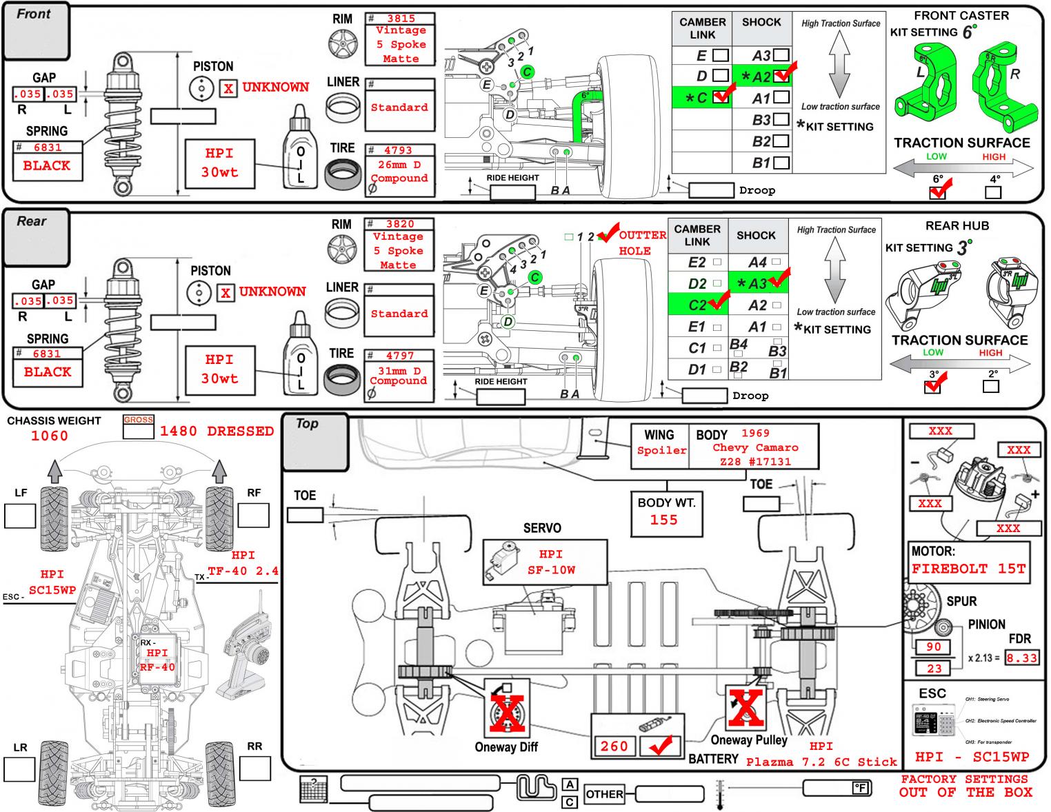

Marv 05-22-2012 04:42 PM
Tensioners & Settings
1 Attachment(s)
Originally Posted by rramjet (Post 10765285)
I thought I heard or read that you shouldn't tighten up the belt tension on these things. Can't remember why. Doesn't make sense not to as far as I'm concerned.
I recall reading that you need 5mm deflection / play in the belt = don't set it too tight.
Got any race set-up info for non treated asphalt?
Got nothing for asphalt -
However, one guy gave me this:
HPI #6847 Blue Springs for the Front
HPI #6843 Yellow Springs for the Rear
-1° toe on the Front
-1° camber on the Front
-1° camber on the Rear
I ran those settings with the 6° C Blocks & the 2° hubs on the rear on an indoor hard surface / basketball court and Pargoned the tires (VTA tires) and it hooked up nicely.
Here's the OUT of THE BOX settings that mine came with (click thumbnail for larger picture):
Attachment 924626
For LOW TRACTION surfaces you could try the HPI recommendations.
I'm working on a C Block Mod to eliminate the slop of the bushings in the C Blocks, the screws and balls in the bushings & the arm screws.
Soon as I have everything together & test it out I'll post it here.

Marv 05-24-2012 09:06 AM
Factory holes -
1 Attachment(s)
Originally Posted by YellowStangDuan (Post 10770154)
Hey Marv, are you running everything in the factory holes, and just changing the alignment? I think that's what I see in the green diagram.
Correct, except for the rear hubs.
Those I changed to the 2° hubs, but I did use the out of the box holes for everything.
I also took out the shock spacer that came installed = this lowered my ride height. On the 'out of the box' jpg this spacer is the 'gap' referred to in the shock section.
Attachment 926004
NOTE: One person recommended that (on the rear) I use the outer most holes on the hubs and the E holes on the shock tower for the camber links.
I didn't.
But that's not to say that I won't try it should I experience traction roll.
It's my understanding that using the outer most holes on the rear will affect the roll center.
So, to recap:
Everything colored in GREEN, as well as the RED checks and RED text, is how my particular S2S came 'out of the box'.
All I did was to adjust the front toe -1°, front camber -1°, switched the rear hubs to the 2° hubs and adjust the rear camber -1°.
In as much as the track I was on was an indoor basketball court the car hooked up quite well, considering the steering slop issues hadn't been addressed at that time.
Another limiting factor was the steering throw / radius = some meat needs to be taken off the C Block stops + doing the -1° tow allows for tighter cornering.
However, too tight on the cornering and the front wheels will hit the lower shock eyes.
So re-adjusting the steering end points is critical.
Pictures and procedures for the C Block mods; pinning the bushings in the C Blocks, reducing ball/screw slop within the bushings, front hub to C block slop and C Block to lower arm slop, as well as the tools & parts needed are forthcoming.
