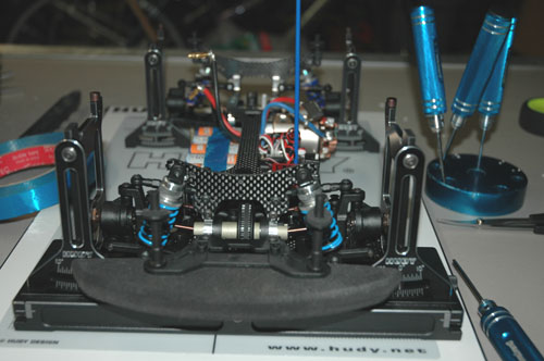

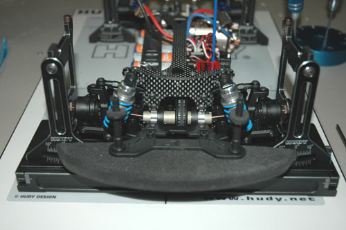

I didn't see a tweek issue, shoudl I be checking some other way? Here's with tape and then with the "gehtto bar 2.0"
It's an RW gear, had to elongate 2 of the holes, I only did it because I was having problems getting into the precisiongearsystems.com site to order their gears and I needed it for this weekend ...I was able to get onto PS last night and ordered up the gears ...in the meantime the RW's work wonderfull, again you just have to elongate teo of the holes, but the center hole snaps into the gear adaptor so there's no cenerting problem whatsoever.

First...That will cause your chassis to tweak BAD. Take it off and tape your batts in.
Second.. How did you get that spur gear in.Thought those didn't fit?

battery straps will only tweak the car if you try to hold the batteries in with vice grip like pressure.
set it properly and it wont tweak the chassis.
