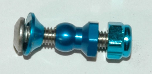

I'm still confused...you used ball nut and then screwed a counter sunk screw thru it? Looks that way on the pics...also do you have a link for the GS washers? Where does it sit on the ball nut? Thx. bro!
No I put a regular button head screw thru them, you could simply use a ball stud (i.e. the ones that come with the shocks) ...or like weaponx said use the normal xray stuff ...I thought the xray shock ends were to "loose" dor my liking on the shock shaft (shock shaft diameter on the Tamiya's is smaller) ...and I went with the screw thru thr ball cup, because I didn't want the shocks "popping off" in the case of a bad impact ...I actually had driven screws even thru the xray shocks when I was using them for this same reason. General silicone's website is down ...but when you can go to www.gsracing.com and the part number is GSCL130BL "3 mm Alum. Cone Spacers - Blue".
..here's a pic of the "assumbly" I'm putting thru the shock ends, hopefully clear up the confusion:
