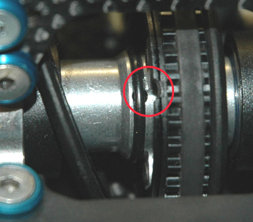

Question guys....the instruction says that there is a hole on the pulley that should line up with the hole on the axle (multi-diff assembly) - I don't see no hole on the pulley! Please advise...thx.
Gary

Dude...I'm serious...I do not have that hole or indent on my pulley!!!!! WTF....
#2455
Yep, I think Xray revised their design...the pin hole is far out enough where you can get to it with out removing the pulley.

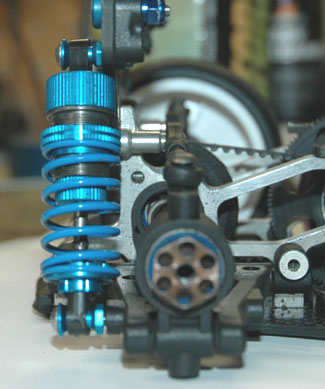

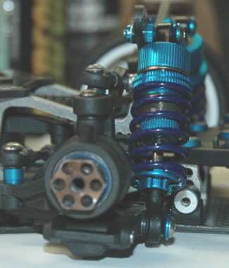

Been getting PM's about the links not working on the cut and paste of my one post re: Tamiya shocks, so here's the info again, it was actually a cut and paste of an email I had sent:
...since that email I have gone to using the ball nuts mentioned at the end of the email with the general silicone cone washers, aditionally I have replaced both cars tamiya shocks with their new "special edition":
http://cgi.ebay.com/ws/eBayISAPI.dll...sPageName=WDVW
So now everything looks like so ...
front:
rear:
OK, here's what you need ---
For Blue:
Shocks:
http://www2.towerhobbies.com/cgi-bin/wti0001p?&I=LXFSA3&P=7
Ball Connectors:
http://www2.towerhobbies.com/cgi-bin/wti0001p?&I=LXFSC8&P=7
For Red:
Shocks:
http://www2.towerhobbies.com/cgi-bin/wti0001p?&I=LXFSA4&P=7
Ball Connectors:
http://www2.towerhobbies.com/cgi-bin/wti0001p?&I=LXFSC9&P=7
Then you'll need 1 of these xray ball joints (Billy may have):
https://www.ssl-stormerhobbies.com/cgi-bin/seekpart.pl?pn=XRA303220
And one of these xray ball ends (Billy may have -- unless you want to try and take out of your xray shocks:
https://www.ssl-stormerhobbies.com/cgi-bin/seekpart.pl?pn=XRA303240
...I used the xray aluminum collars as the Tamiya ones where "cheezy"
You will also need 4 - 3 mm lock nuts (you can get @ Billy's or Ace Hardware in Roseville)
On the ball connectors, the shocks come with gold ones, so the colored ones above are just if you want to "color coordinate",
OK, now for the front shocks, you will use 2 of the ball connectors with 3 mm nuts for the top into the shock tower, and 2 of the Xray ball joints with the ball ends put in them on the shock shaft, you'll need to cut the ball end just above the "nut" looking thingee ...where this red line is:
This will go on the bottom with a 3mmx10mm screw into the arm, I made the from shocks 65mm ling
Now the rear shocks, you'll use the short connectors in the tamiya set for the bottom of the shock, you will use 2 of the ball connectors with 3 mm nuts for the top into the shock tower, for the arm you'll screw 2 of the ball connectors into the arms, I made the rear shocks 61.5mm long
xray springs work perfectly
I'm getting a set of these:
http://www2.towerhobbies.com/cgi-bin/wti0001p?&I=LXETK6&P=7
That I *think* should work instead of the ball connectors were I can put a 3mm screw through them (the ball conectors make me "nervous")

#2459
I'm still confused...you used ball nut and then screwed a counter sunk screw thru it? Looks that way on the pics...also do you have a link for the GS washers? Where does it sit on the ball nut? Thx. bro!
