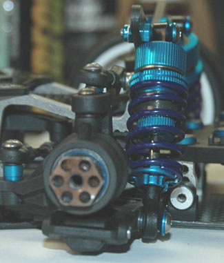

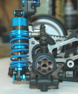

I got the ball nuts today from tower and they work KILLER ...the shock wasn't rotating as much as I'd like it to on the ball once I put a screw through it so I put some General Silicon coned washsers with the coned side toward the ball and they work PERFECTLY ...now no worries of anything "poping off":
front shocks:
rear shocks:
