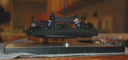

Where did you get those scales? ...I got the Hudy Balance points but that doesn't help my front to back balance ...it's still kewl to see though:
HarshGuy is offline
Go to a local store for home "stuff" and look for small food scales. I picked up four digital ones from Bed Bath & Beyond for $19.99 apiece.
I used to test my four point balance by using the Hudy balance points under two home-made dimples that I put in the exact front/rear center of the bottom of the chassis. Then I made another dimple in between the two, with a balance point underneath, with either end of the car hanging off the setup board and a small screwdriver point in the pre-made balance hole on each end of the car to see how far off the left/right balance was at each end of the car. (had to go back to my grade school geometry class to measure the intersecting point and checked my measurements 3 times to make sure). Cryptic writing, but not much time to put this post in at work now...
