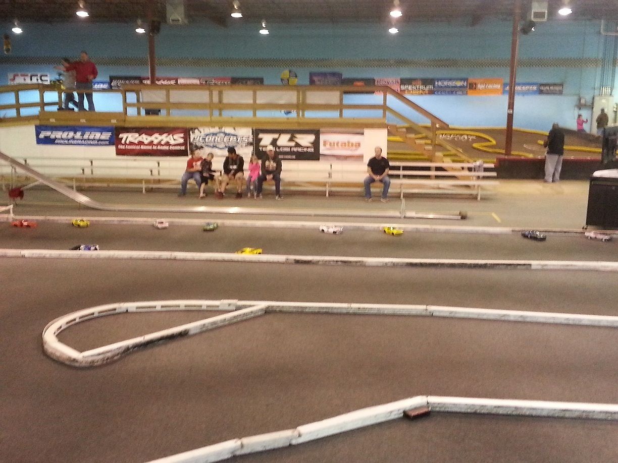

edit: this was the view of our 10+ car VTA race this last saturday at Mike's in Carrollton (need to resize and clean it up some). Great racing and most importantly alot of fun!
for the record, yes those are VTA racers (who shall remain nameless) driving from Mike's offroad stand.....
