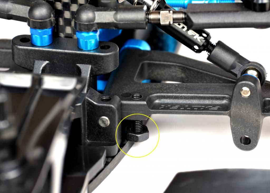

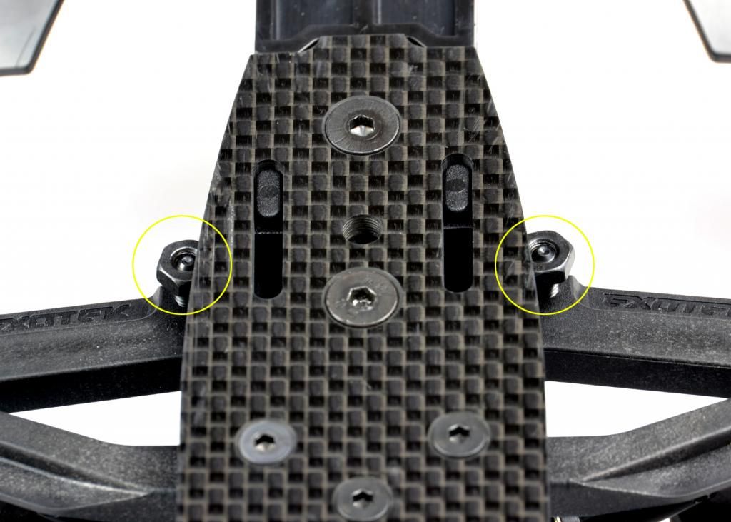

F104 and SpedPassion owners rejoice! Simple IFS adapters.
Thanks to mtveten for reminding me of the easy droop fix, I had a chance to mock it up for the F104 type chassis
Very simple- Just thread lock an M3 nut on each set screw end;
Still must drill 2 center holes if you wish to use the F1R2 servo mounts. The IFS instruction sheet has a template to show you where the holes should be made
INSTRUCTIONS- SEE STEP 11.
