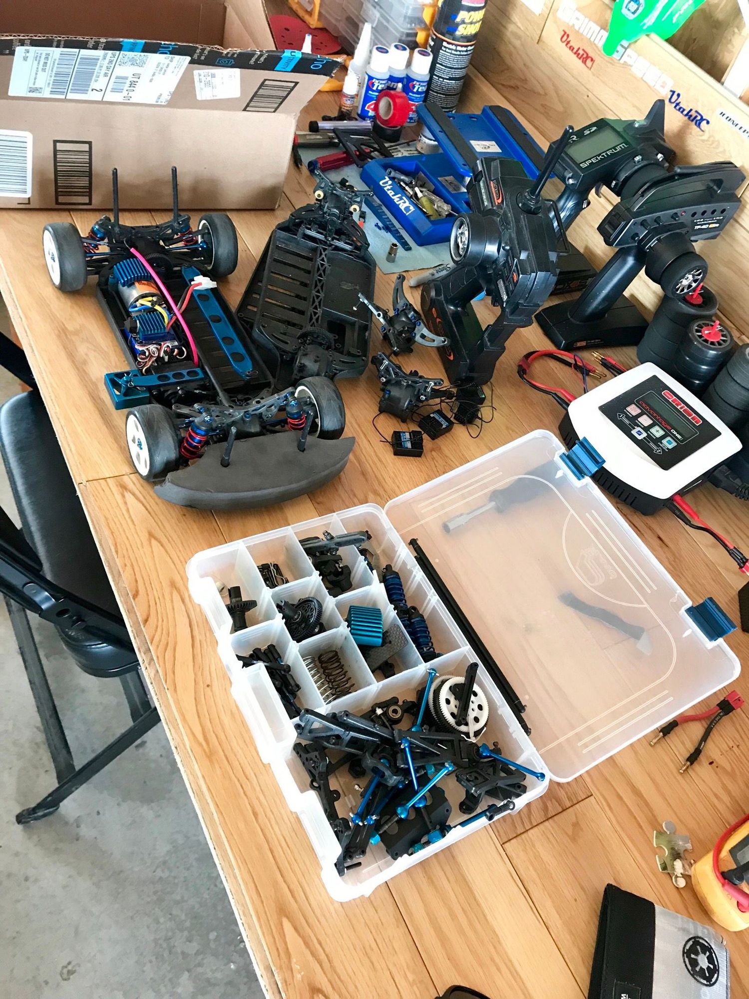

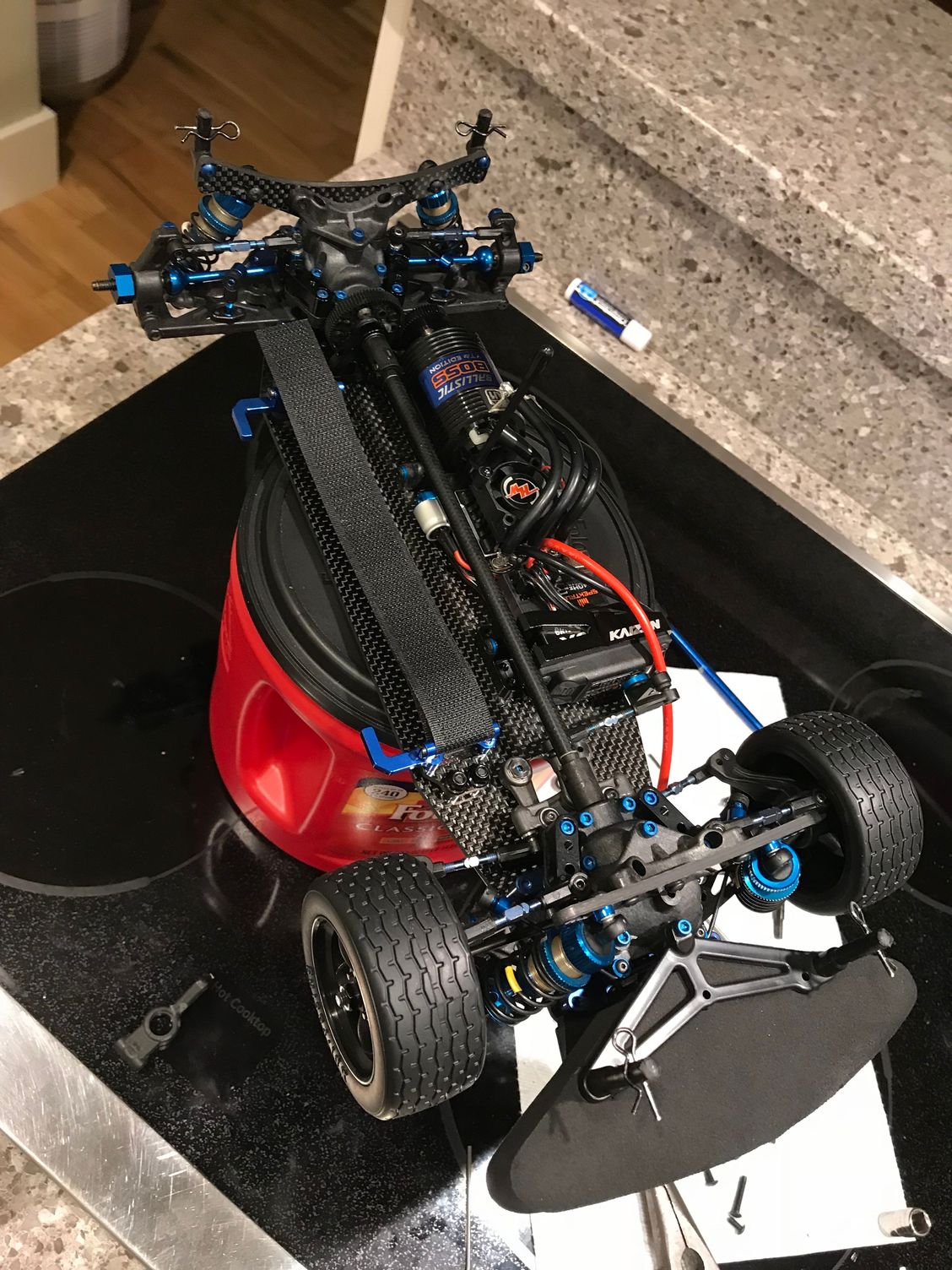

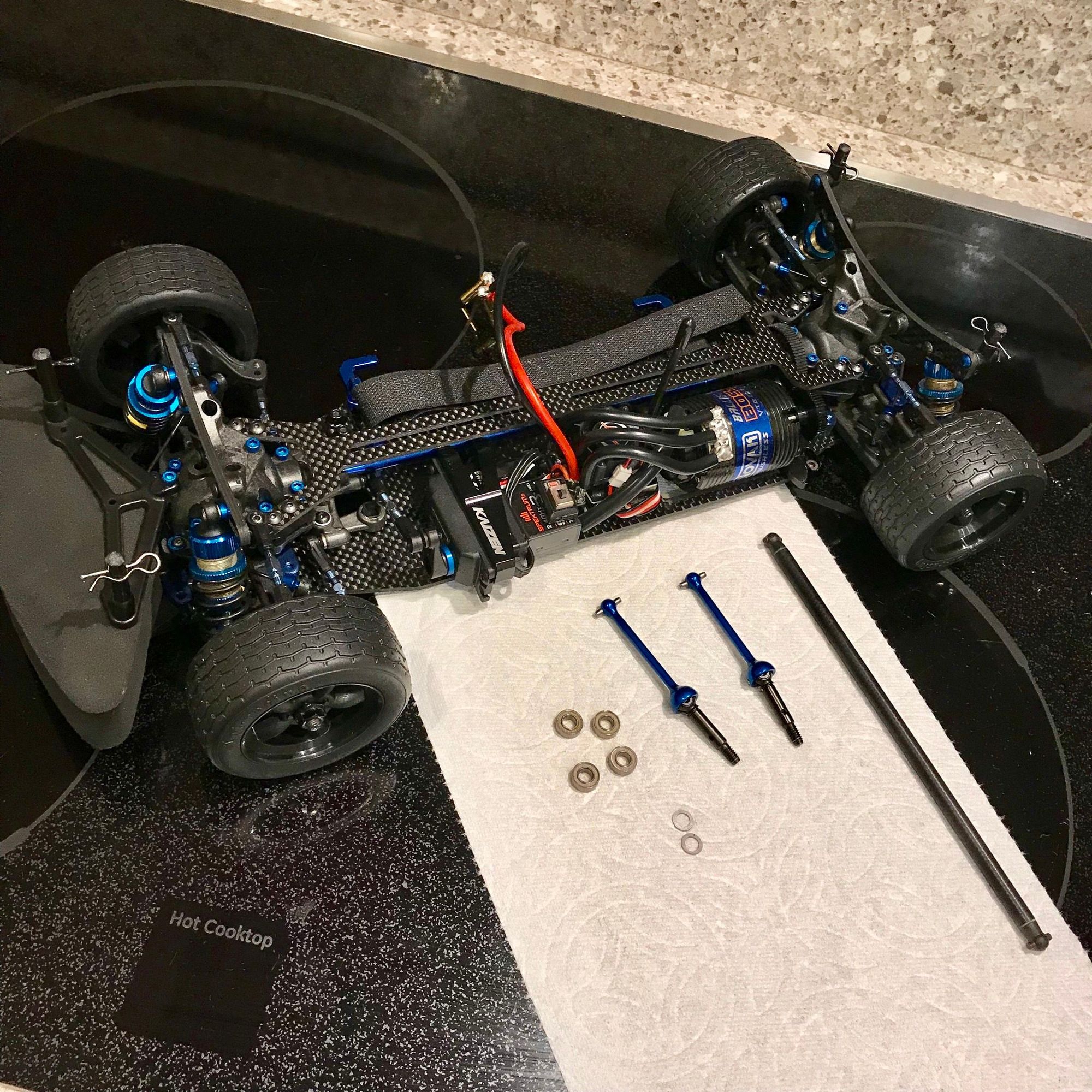

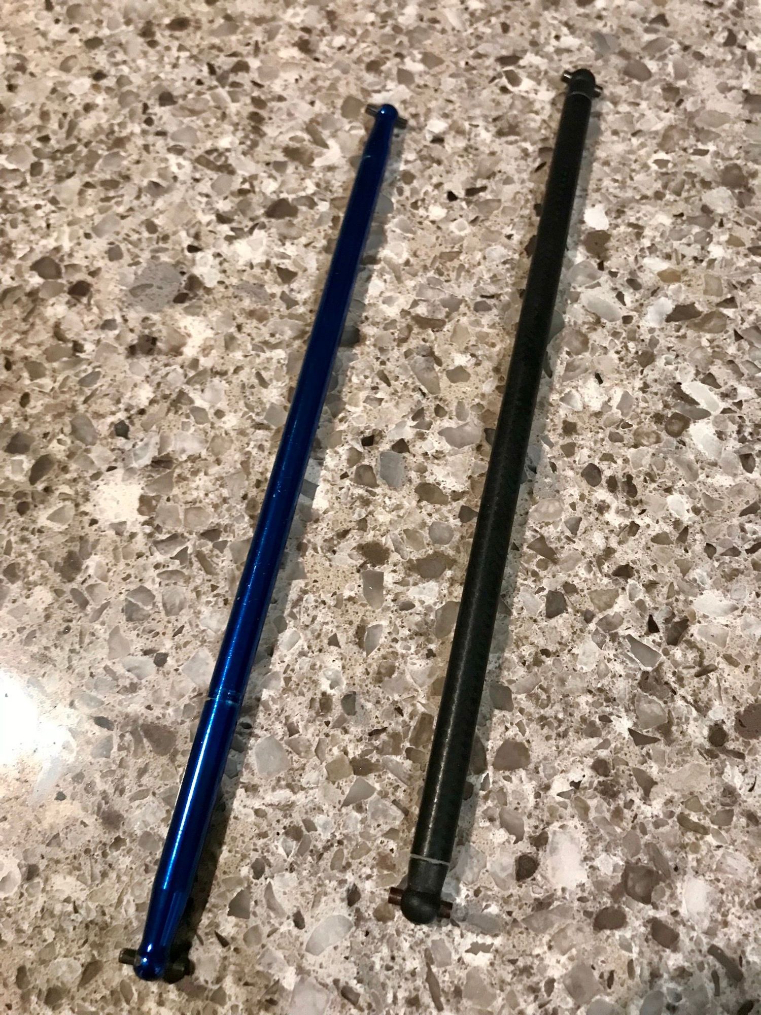

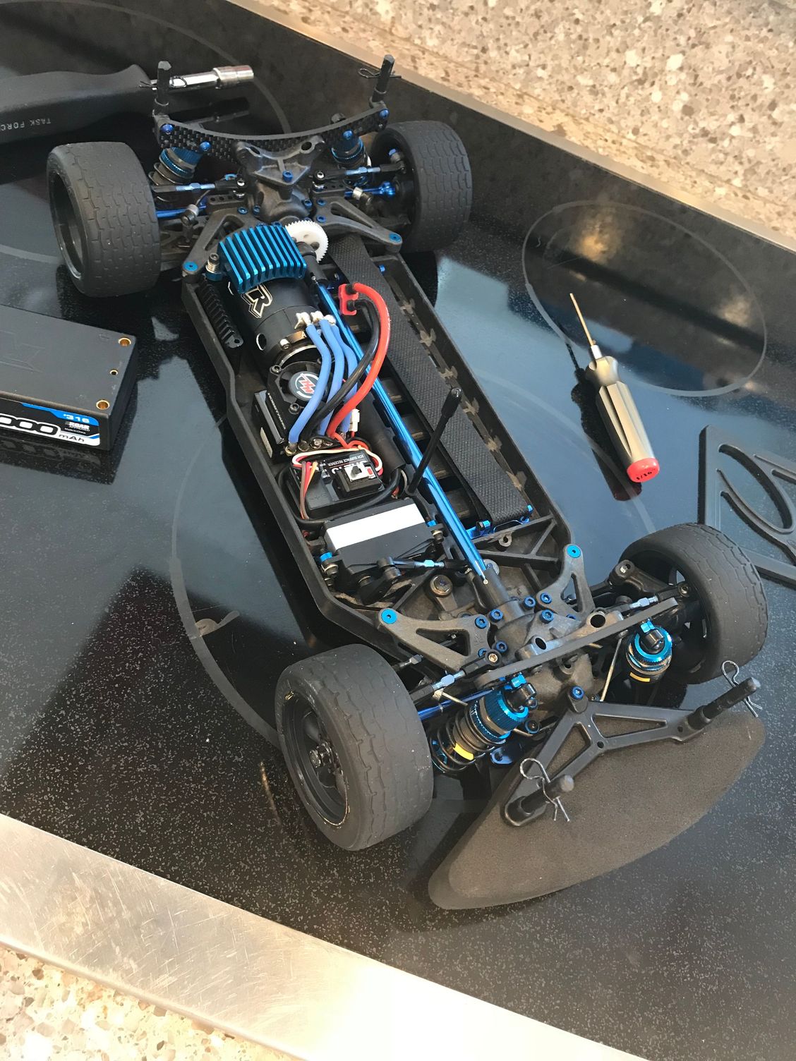

Tonightís project was focused on my Kaizen converted TC4. Today I picked up a TC3 that included a bunch of extra parts so I decided to use some of them. I swapped the blue aluminum driveshaft for a TC3 graphite driveshaft (with proper drive cups of course). Once that was snug I also swapped the rear axles Iíve been using, which were the NTC3 steel axle assemblies (asc2402) for some lightweight aluminum assemblies. Iím not exactly sure which ones they are, the asc3888 or 3889 but theyíre more narrow of a diameter than the ones on my other TC4, and they are the darker blue. The fronts wonít be getting the blue treatment since I run the tc7.1 DCV on this car. I cleaned and installed some PTFE bearings as well since I have a bunch from the TC3 sale. I have some blue turnbuckles to install on my tub TC4 tomorrow if I get around to it.
Todayís score!
New (old) parts going on
Aluminum vs graphite
All buttoned up
fircrest is offline

I don't think that's actually a graphite driveshaft, the official TC3 one was a composite material.

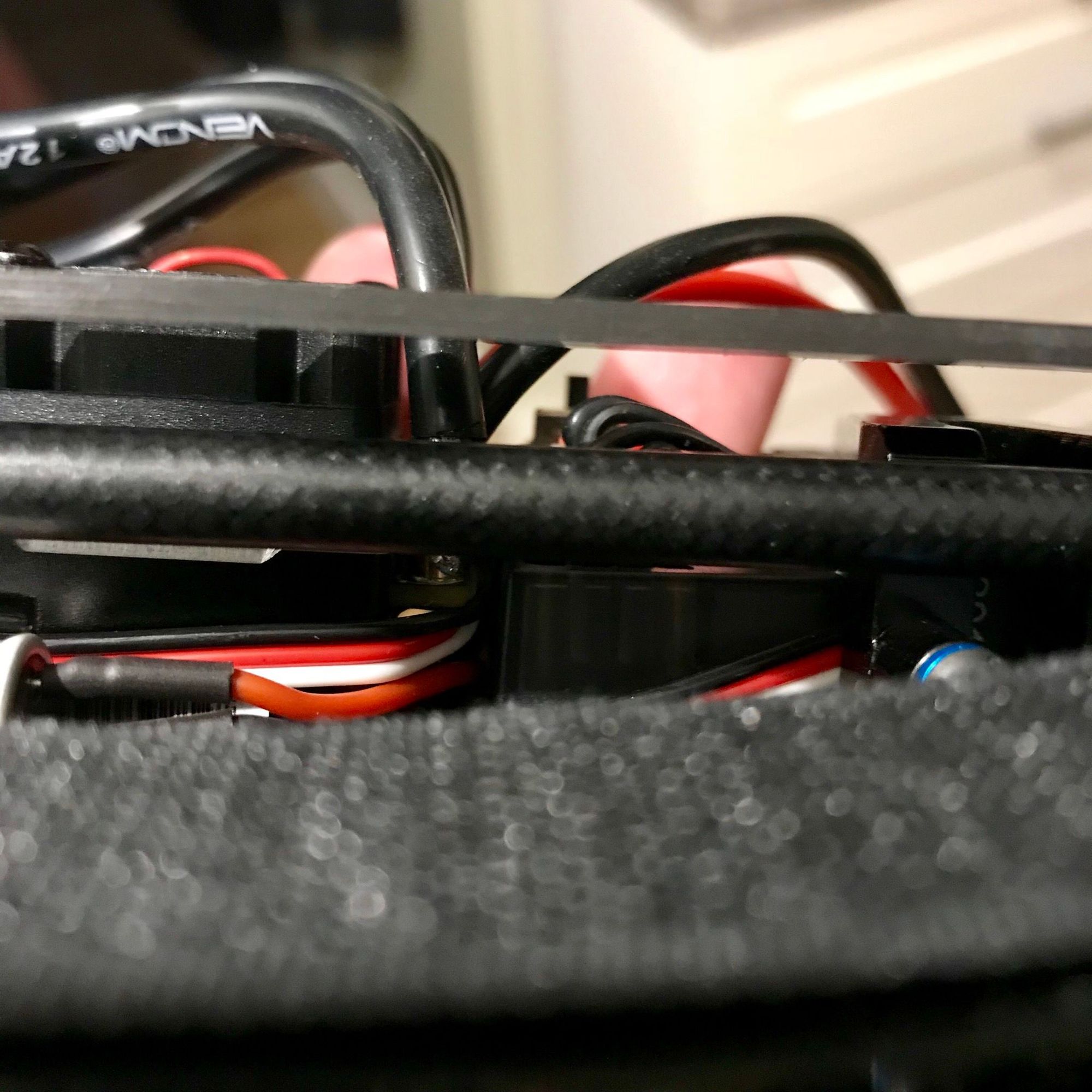

This one is definitely not a composite material (maybe the ends but thatís it), the shaft itself is a carbon/graphite material. I have three of them now, and they all make the carbon fiber ďsoundĒ when tapping my front teeth. I havenít weighed them yet but they are lighter than the aluminum shafts I have also. I will snap some more detailed pics when I get a chance today.

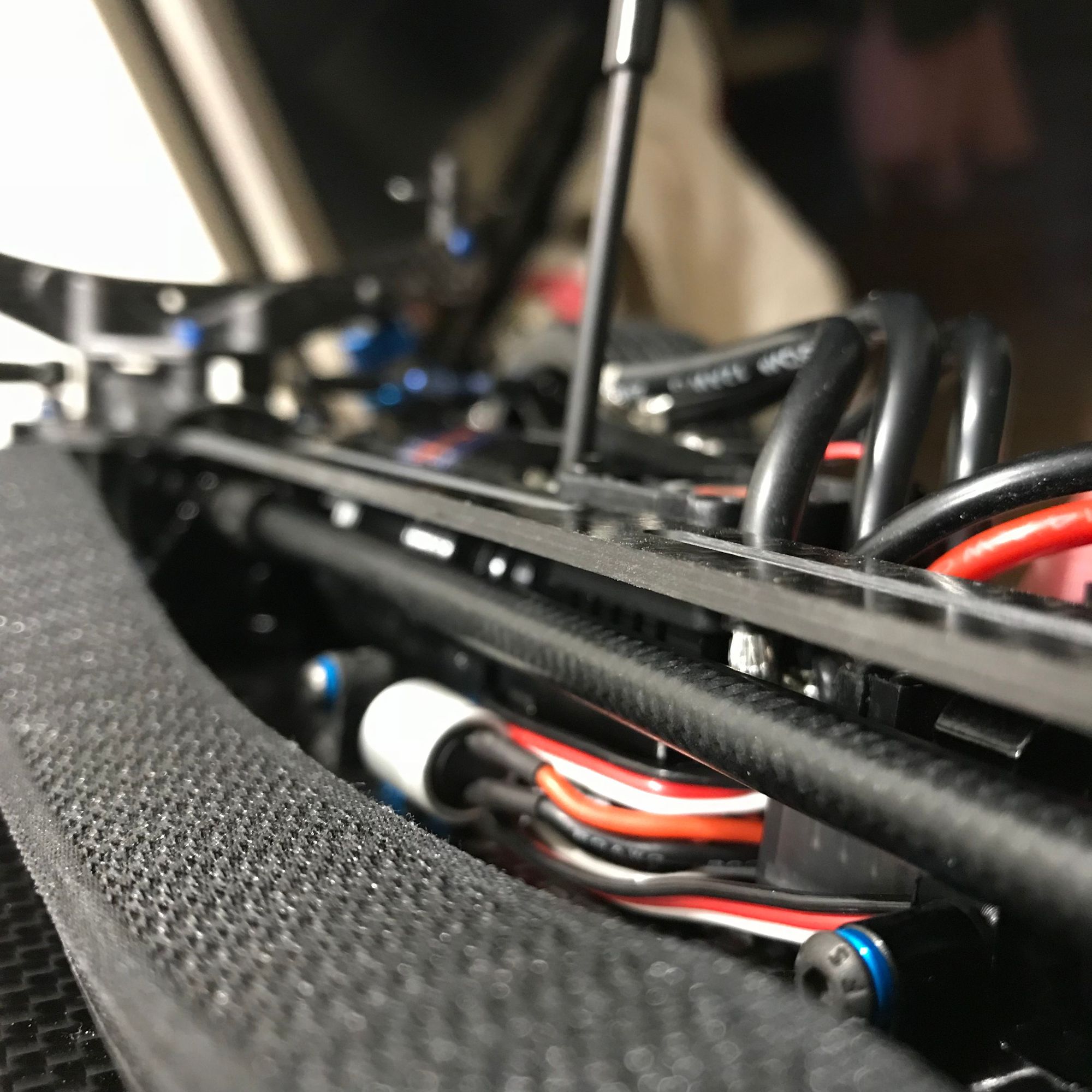

Location: SLC
Posts: 69
Best I could snag at the moment, you can definately see the carbon fiber weave. I believe the TC3s I picked up are the factory team kits so there are some pretty neat parts in there.

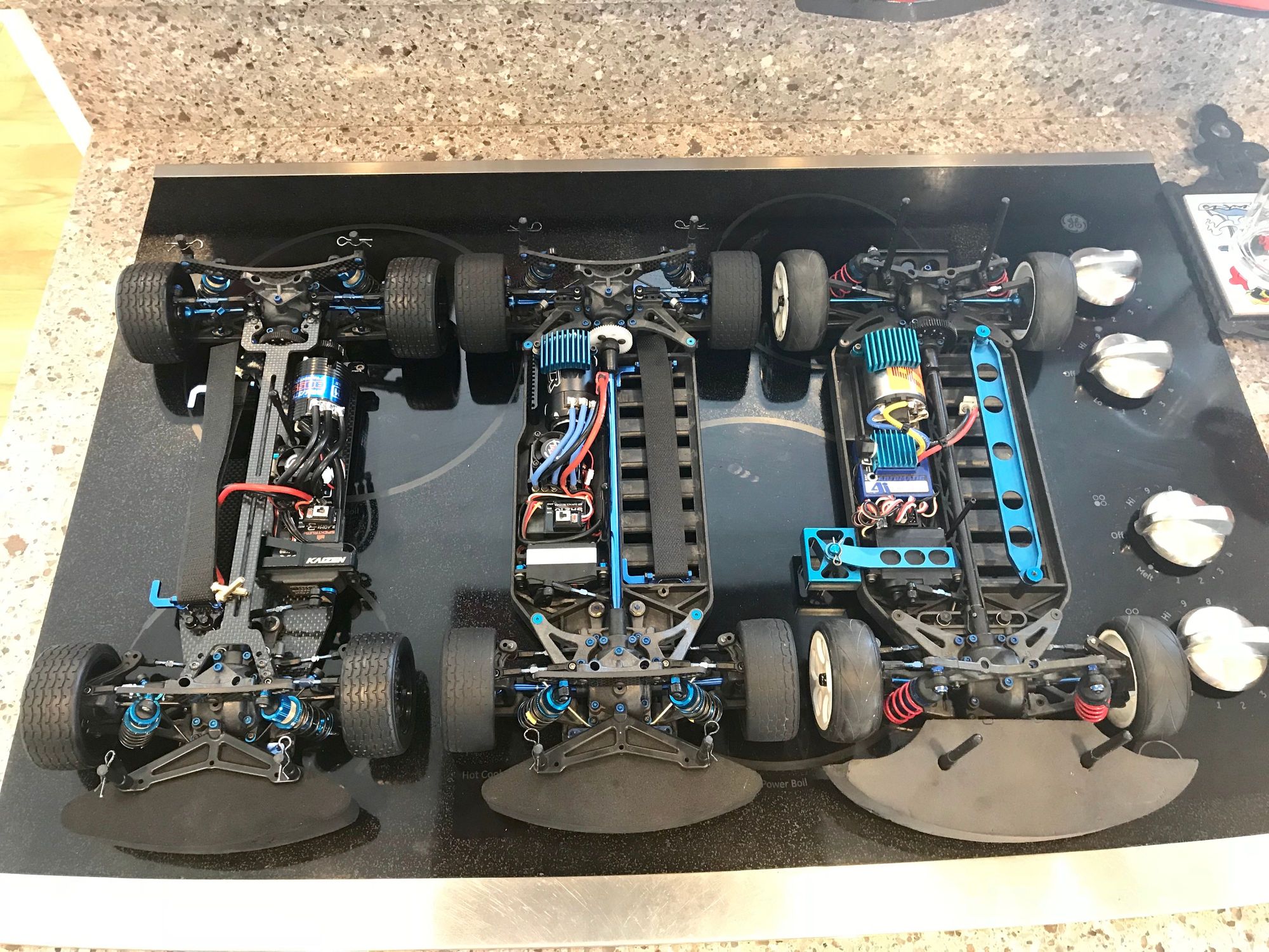

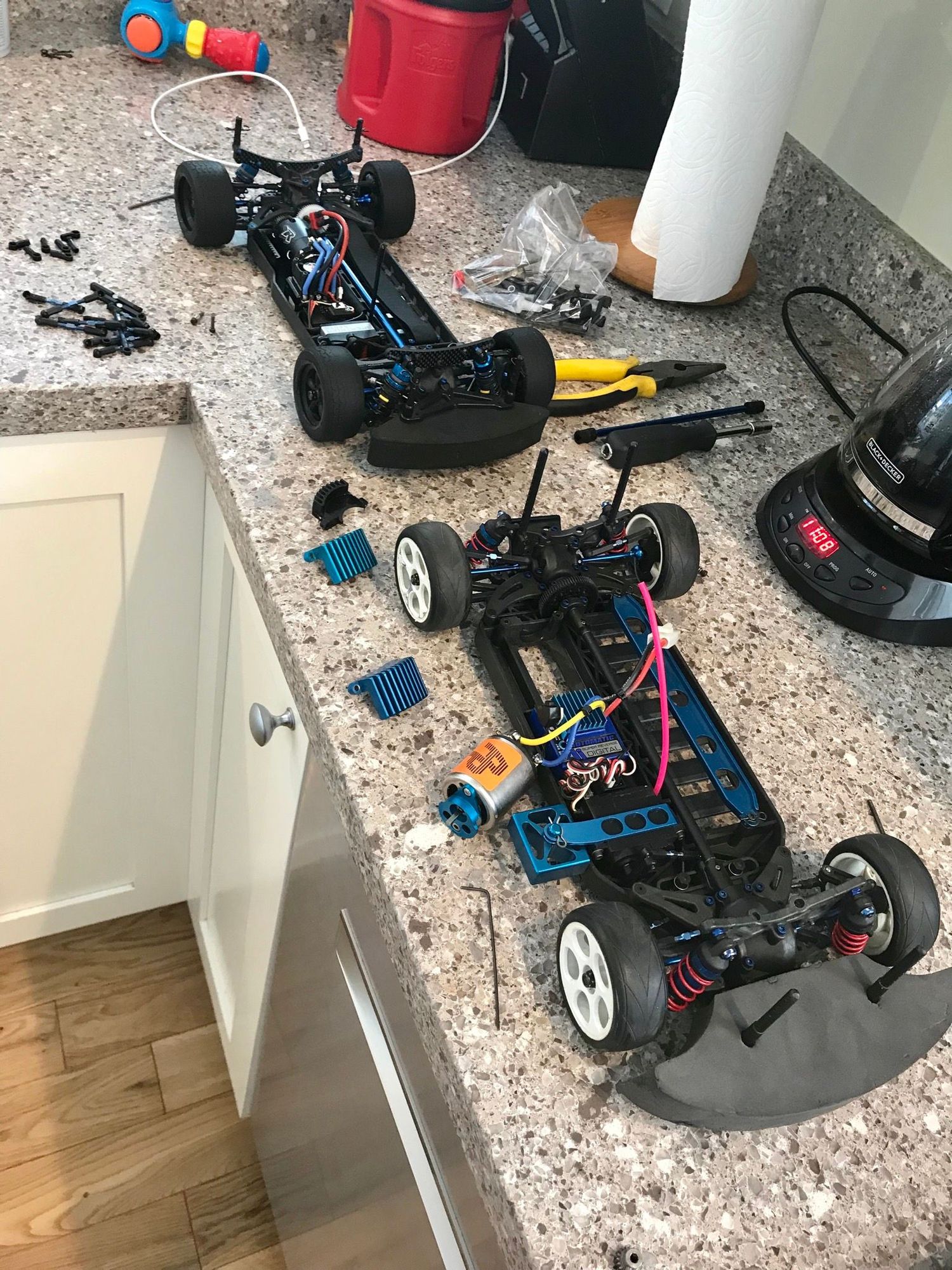

More fun today! I installed some blue turnbuckles and a blue motor heat sink and aligned the tub TC4. I also cleaned and inspected the newly acquired TC3, Iím still deciding on what direction to take on it - or even if I want to keep it haha
Too bad we still have about a foot of snow on the ground here, I really want to take them for a spin!
Let the fun begin!
All three of the lovely ladies.
Blue turnbuckles and motor heatsink now installed.
That's the stock composite TC3 shaft. It has a weave pattern. The Factory Team TC3 upgraded shaft was aluminium. They eventually discontinued the composite shaft and replaced it with aluminium in all their kits.
Here's the composite shaft from my TC3 Racer kit (basically same spec as the RTR but in kit form)

I thought I scored something cool haha. I've been reading some OLD threads on here and everyone called it a carbon shaft, and that it's 3 grams lighter than the aluminum one. I'll drive it around when things dry up here and see if I like it more than the aluminum one.

Just read that the shaft is three piece, the shaft itself is carbon and the ends are composite that is pressed/glued in. Still neat to me haha
