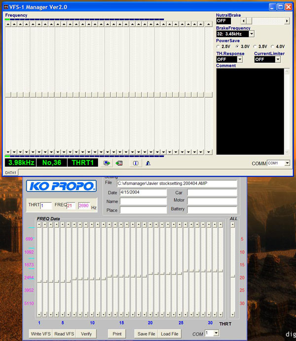

OK so I don't understand how to "relate" the VFS1 settings to the 200 settings e.g. how would I set the VFS1 to get "closes to the same" seetings on my 2000 given the 2 images below, the 1st setting on the 2000 says Freq 21, 2690 Hz, what would I do on the VFS1 to match that?

Yep that's what I found as well, so I was gonna "manually" match my existing profile and play from there, and that's where I have no clue how to "relate" the 2000 settings to the VFS1 settings

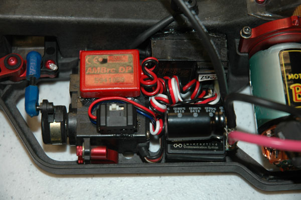

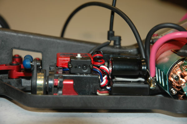

Here it is all mounted up ...now all I need is KO POPRO STAFF to lmk about the settings

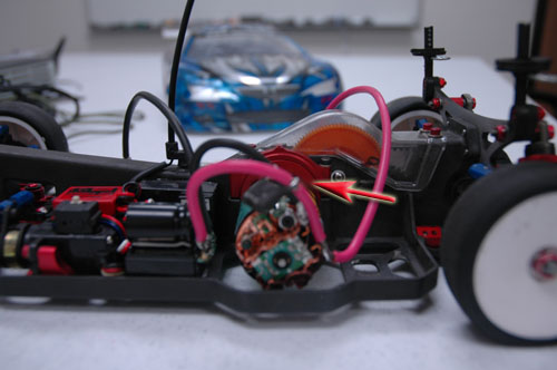

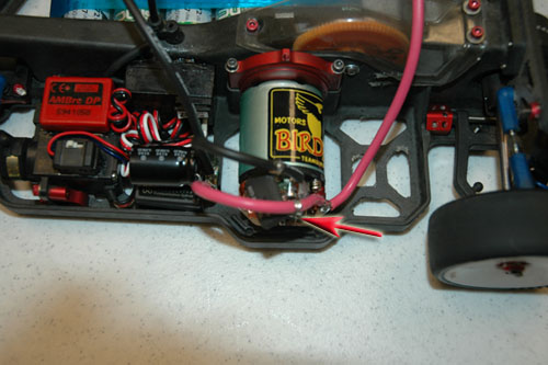

Here's what I did with mine ....I've always mounted my shotkys on the motor wires "close" to the motor, that way I dont' have to put them on every motor, never had any problems doing it this way.

You will have to manually correlate the old info to the new info. Look at the frequency Hz in the upper left corner of the old software for each step and input the closest frequency into the new software for each step. The Frequency Hz on the new software is displayed in the lower left.

The new Ultimate shotki diode (single) has the power of two of the previous super shotki diode. This is what comes with the VFS-1. This should be good enough for 19T and most mods. Lower turn mods would require the Ultimate Shotki Diode (Double) which is double the power of the single Ultimate Shotki.
As far as mounting it directly onto the esc it self, it will work but the efficiency of the diode is improved if it is on the motor or as close to the motor as possible.
