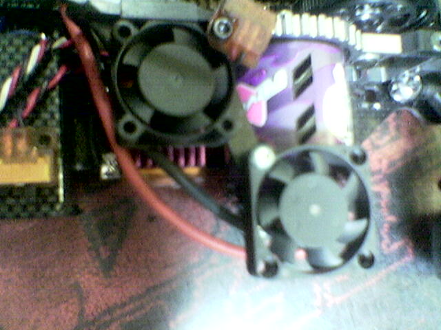

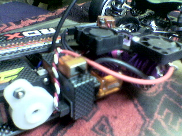

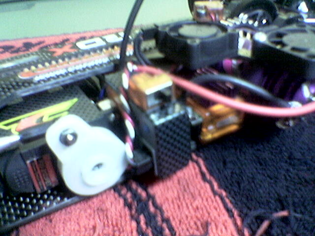

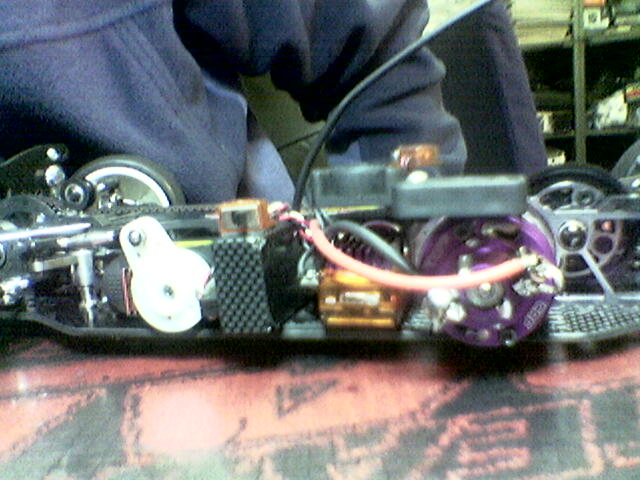

Here's my electronics layout (taken with phone camera , hence the brilliant quality!)
Std size KO servo, Spektrum Rx, GTX ESC and two fans for ESC and motor.
