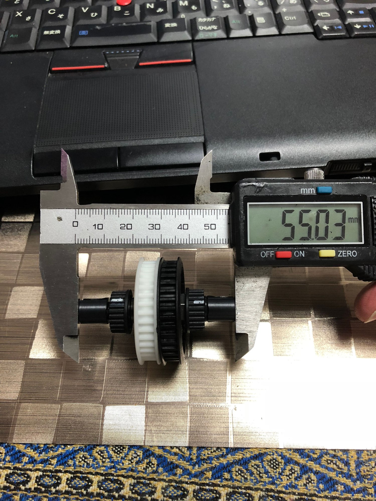

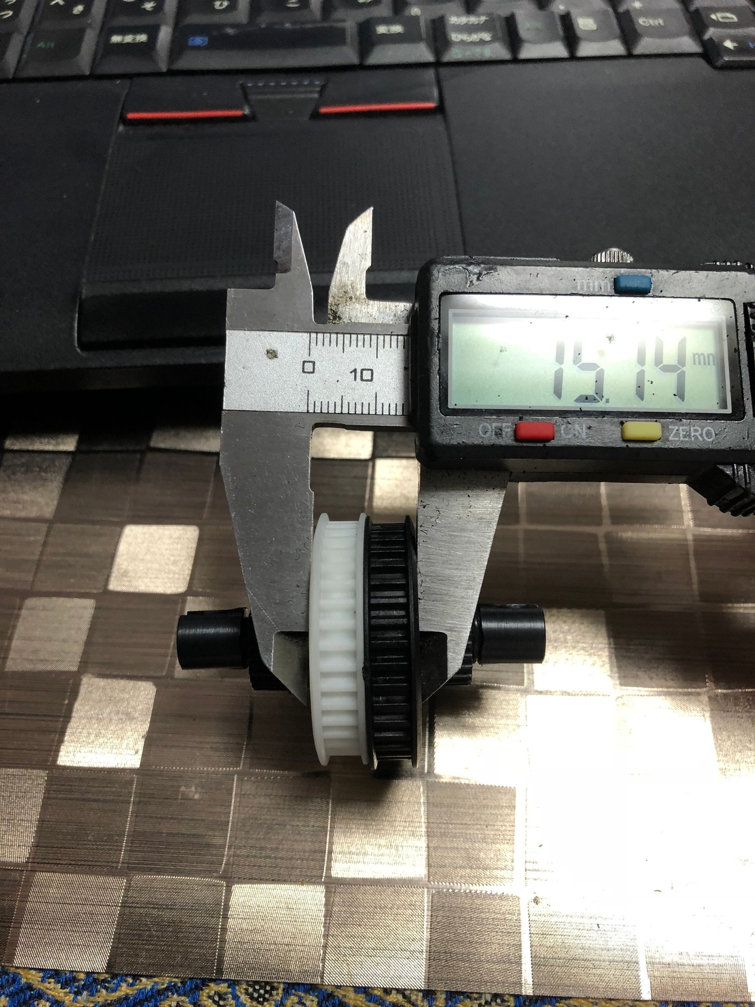

Iím feeling a little nostalgic and considering to purchase a Mi1 V2 as a little project. I noticed the car doesnít come with a gear differential, but I do have an Awesomatix gear differential handy. Quite possibly the AMX gear differential and spool might work.
I personally donít have a kit, but if someone does and wouldnít mind sending me the dimensions of the rear differential that would be great.
5th wheel and ImacFanatic like this.

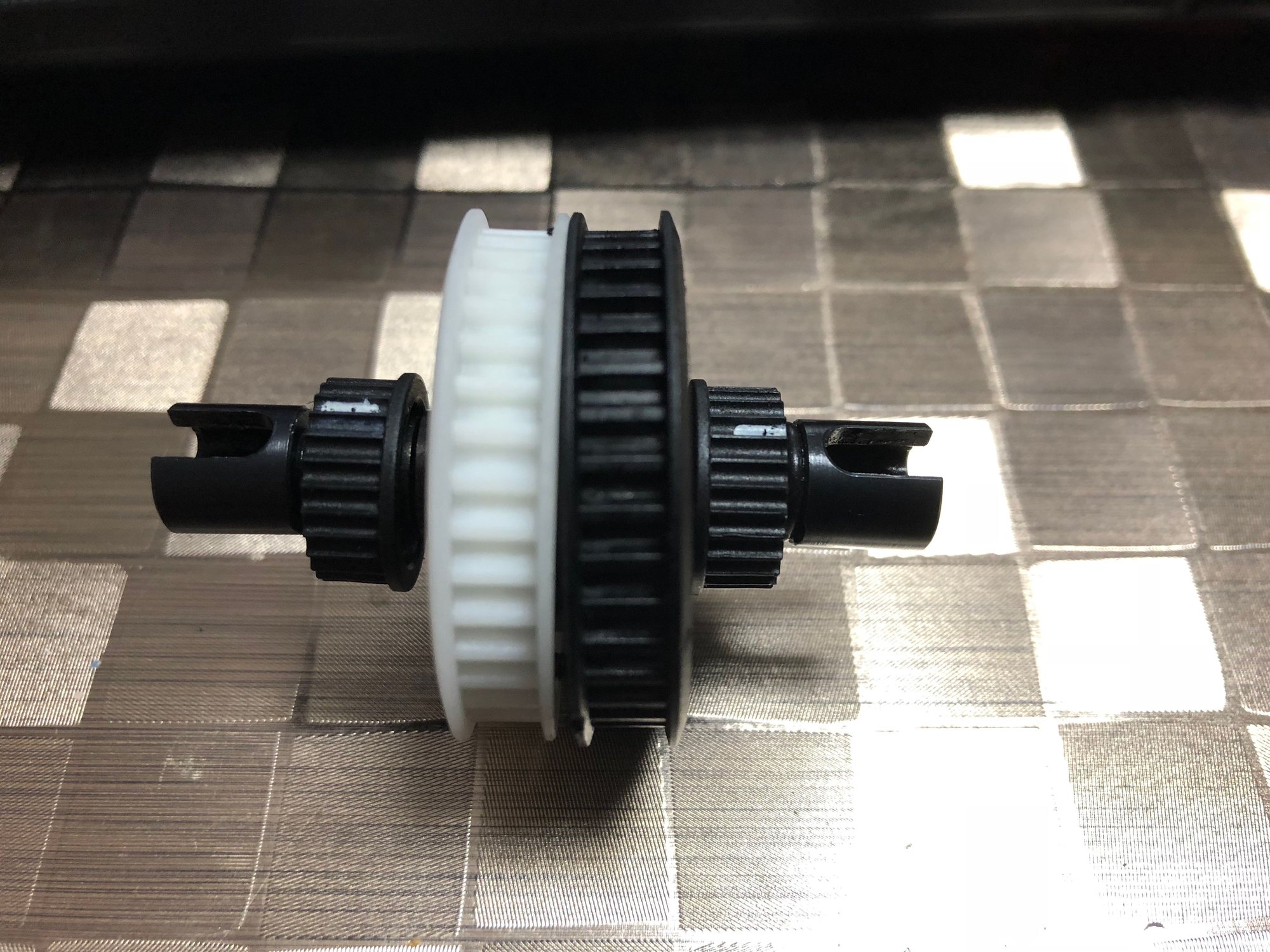

This is the standard differential that comes with the Awesomatix A800 series.
I will also thinking that it might be possible to 3D print a pulley to fit the Awesomatix differential.
The two pulleys pictures are not bolted together. They will need to be bolted together with a long screw.
