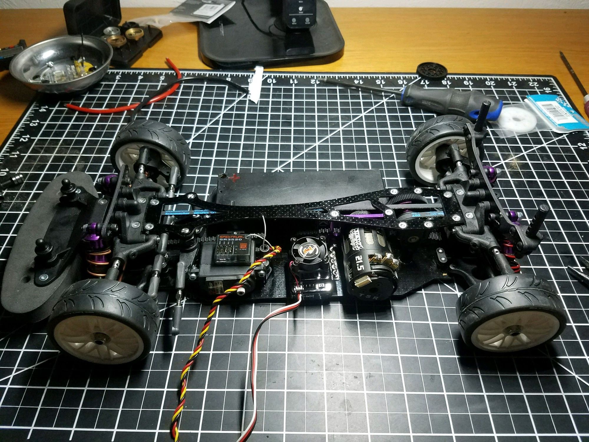

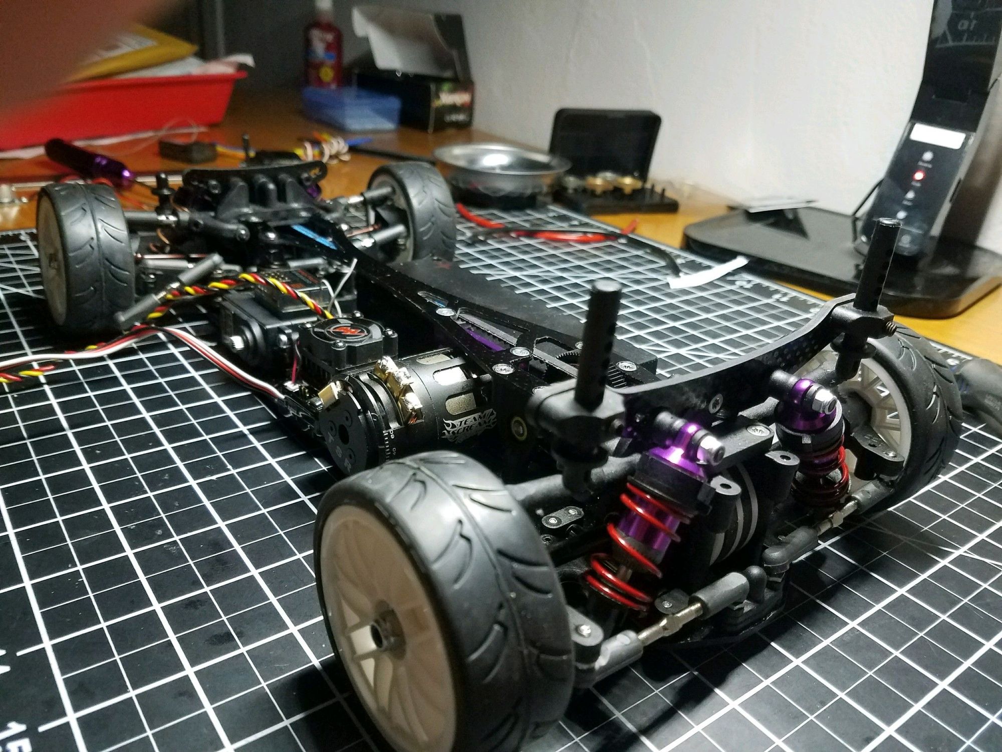

I put my M1V2 on the track last weekend in USGT and it did remarkably well considering the field I was racing with, xray,yokomo, team c, tc 7.1 etc.
I went back to the kit green springs and actually put the front diff back in and shelved the spool. Seems my driving style is better suited to the diff, someday I'll learn to control a spool.
DNF in the main due to radio issue but held its own for sure. All around good car yet would be best suited for VTA class.
My AUW with a 6000mah pack is 1469. Almost 800g heaver than the 1380g weight for USGT and a 5000mah leaves it off balance.
For sure a near bomb proof chassis, I made no repairs, set up, tweak or re adjustments on station all day and that's a first.
The only upgrade on it now is the 64p gear adaptor and alloy lay shaft pulley.

Is that a hw v3.1 in your mi1 ? What’s your esc setting s I need a place to start its been a while since I used a HW .the 120amp

I got lucky and won an eBay auction for 3 of them for 150.00 , used but all work well. Just Stock was in everything before.
the HW 3.1 is great the base blinky setting works well and I added 10 on drag brake and lowered the punch , everything else is stock settings. I did have to turn off esc, voltage and motor temp fail safes, it shut off mid race in main from false reading, probably from the sensor wire ? . Man, I ran in a boosted mode in practice and blinky sure is a whole lot slower.
the HW wifi module and app is a treat to use. Highly suggest one if you don't have one already.
