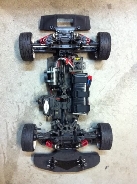

Old 11-13-2011, 06:56 AM
  #1129
ncracer409's Avatar
Join Date: Jun 2011
Posts: 60

Originally Posted by romuald31
Hello from France,
I'm planning to buy the GTP2E with the SNR parts. (Thx Steve, great guy, great service!!).
I'm looking for pictures of GTP2E + SNR parts, especially the CF chassis with the front DM1 bumper.
It will be powered with HobbyWing 150A + 2250kV sensored motor and 4S batteries.
Au revoir.
Romuald
Here you go.
