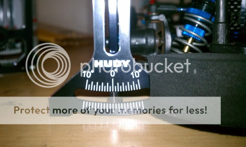

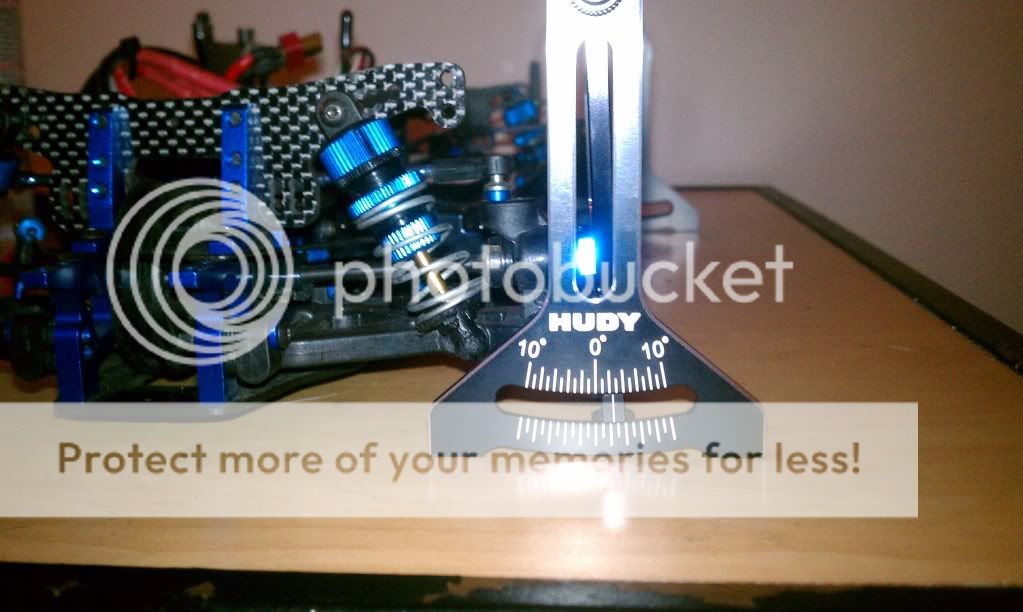

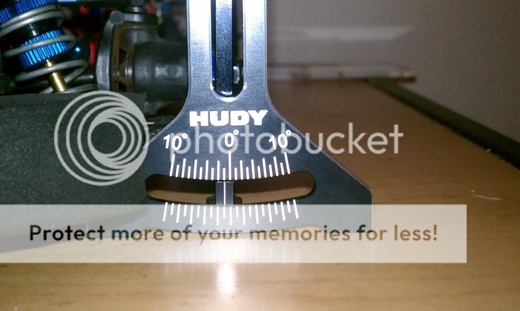

Can some please tell me if I'm reading these camber values correctly...sign wise in particular.
Front Left: -0.5 deg
Front Right: -0.5 deg
Rear Left: +2.5 deg
Rear Right: +2.5 deg

Your values are opposite. Your negatives are positives and positives are negatives
Yup, backwards. You should never run positive camber, ever.
