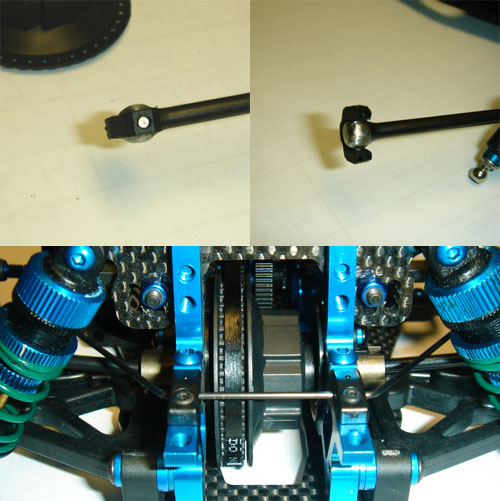

Originally Posted by spring71
Using Spec-R Yokomo BD5 Gear Diff for TC5/TC6.
It fits, but the CVD and out drive is tight.
Need to sand off CVD ends a little bit to make room for out drive.
Click here for more information.
FYI.
What's a good starting point for oil in the gear diff?? Running the car on a tight technical outdoor asphalt track. Medium to high grip.

Originally Posted by KHoff7
Might they be available before paved nats at the end of July?
I hope so but I am not optimistic. Sorry!
Originally Posted by Potoczak
Hi Rick, are the Yokomo diffs a direct drop in or do you have to modify parts??
There are two diffs for the Yokomo BD5 that work in the TC6, one from Yokomo and one from Spec-R. I can't say for certain that the same modification is required for each but it should be.
First, the Spec-R diff is slightly too wide which means you will need to modify the main diff bearing holder so that the diff will fit. There should be a description of this mod in the Keven Hebert/TC6 question forum. You can also turn the diff in a lathe and remove material where the main bearings ride. I don't even think the need a lathe. If you can spin the diff (drill press or dremel?) you can sand the material away. You don't have to remove much.
Second, the drive cup is too small for the AE bone. Some people modify the dog bone or you can grind the cup (this is better). It does not take much to make the bone fit.
Originally Posted by Verndog
Great news! Are they going to be setup to run blades or raw bones??
Blades.

Yes you can also changed the dog bones for yoks, but then you need to change the bearings in hub and have different hex holders (Xray works fine apparently)
the SpecR is deeper in outdrives than the original yoks.
So any ideas on releasing date for AE gear diff? I can wait until end of August for mine, the season restart in September.
