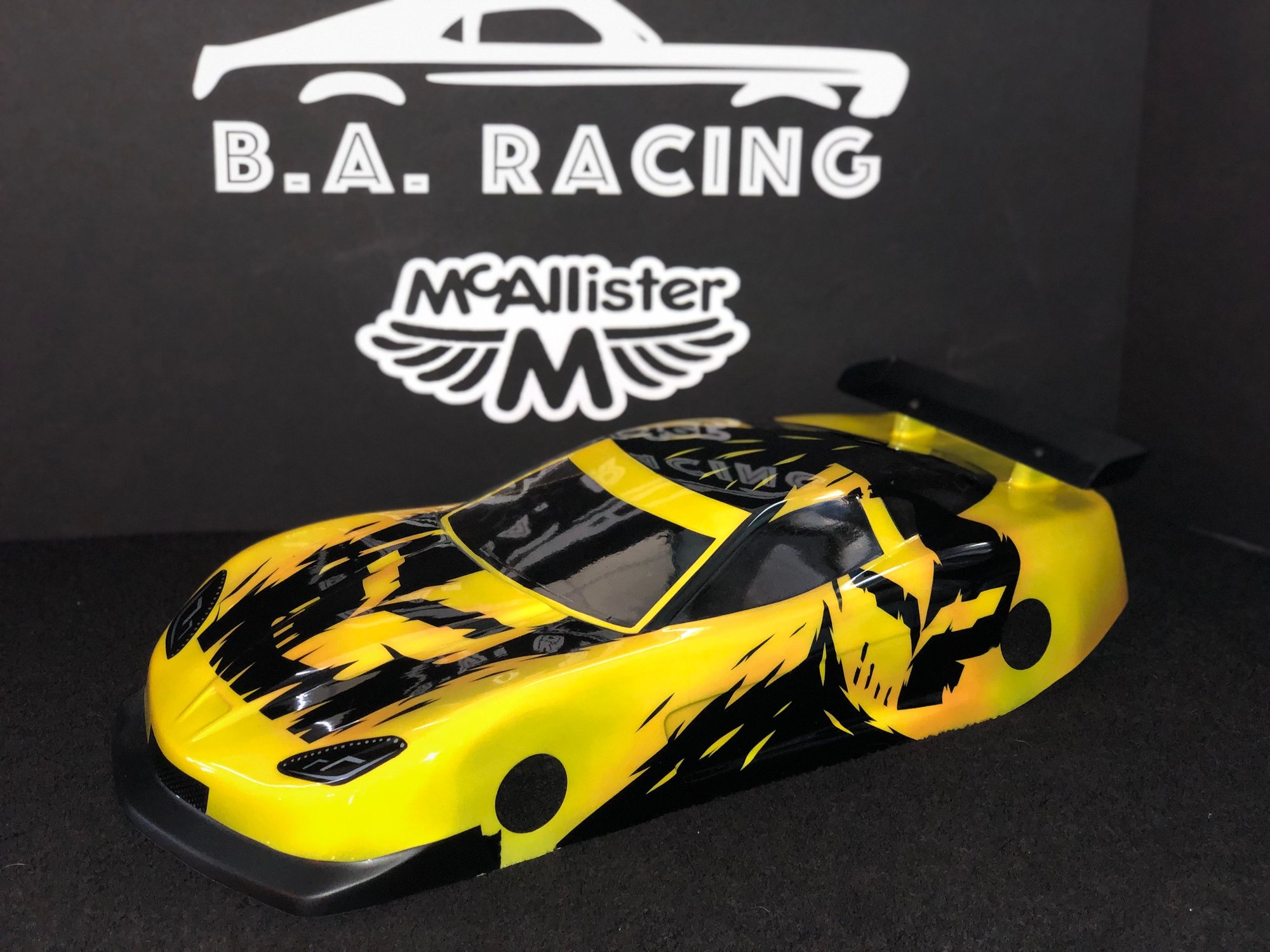

theproffesor 05-21-2019 10:52 AM
https://cimg9.ibsrv.net/gimg/www.rct...677ac3c9a.jpeg
https://cimg7.ibsrv.net/gimg/www.rct...14f2ef047.jpeg
https://cimg6.ibsrv.net/gimg/www.rct...66f04323c.jpeg
https://cimg8.ibsrv.net/gimg/www.rct...8749e82a5.jpeg
A couple of McAllister bodies I painted up this week. Definitely going to try the C6 Lemans for my next race body.
