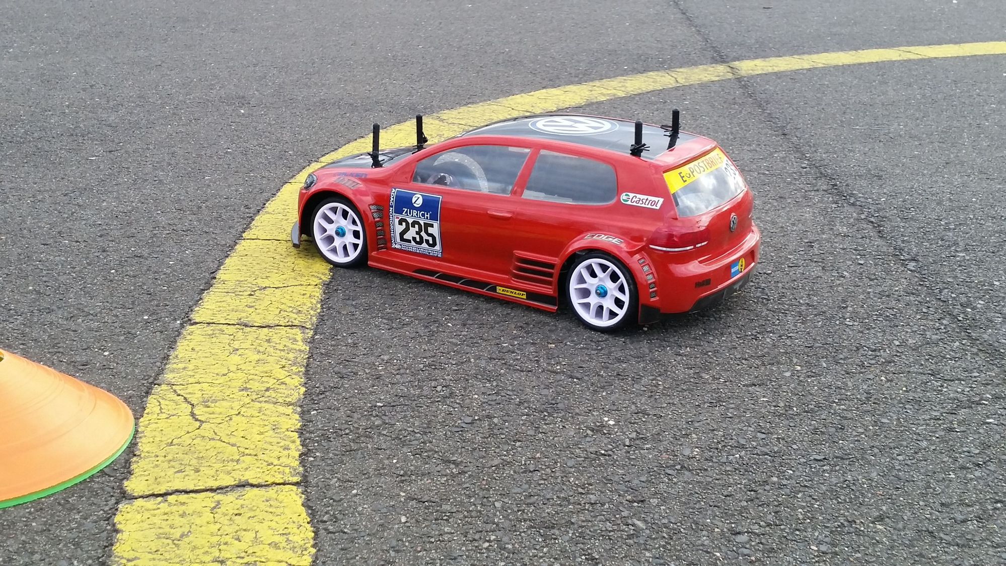

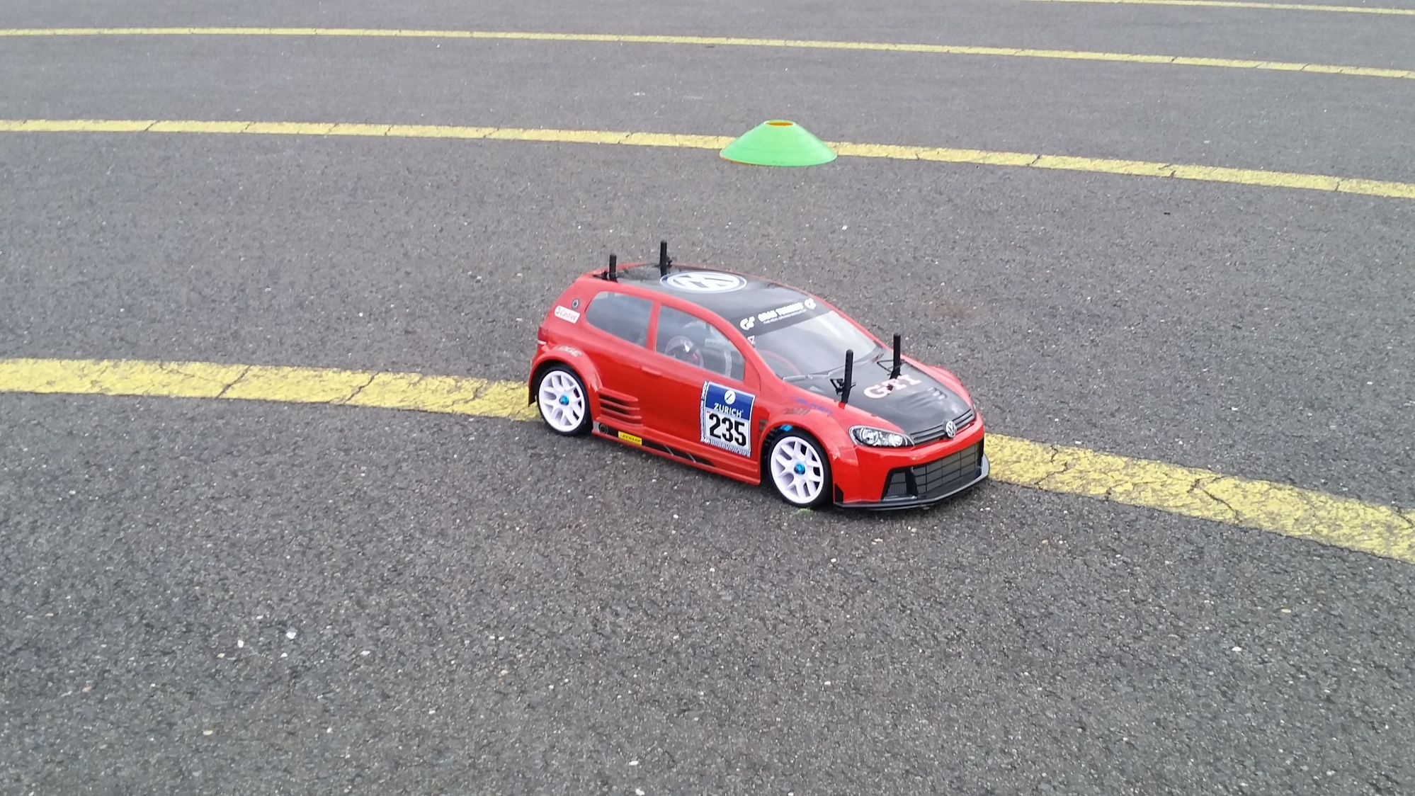

Beside my own car, my friends and I still race our normal FF03s. Mine is a blast to drive. It carries a lot of speed through the corner, allows late dive bombing and very early acceleration. Also it got a new Scirocco body, based on Simon Larssons car, that I want to show off
I finally wrote down the setup for all who are interested. To save money I used parts from my old AE TCs like the springs and dampers...
Datei von filehorst.de laden
cartix likes this.
/// CAUTION: Rogue robot \\\
wtcc is offline   Reply With Quote
Old 01-28-2018, 06:39 AM   #3024
Join Date: Jul 2016
Posts: 504

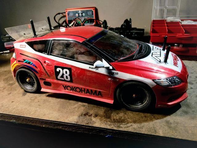

Your car looks great!
I love that body and wing especially, paint is on point.
I just looked at your setup sheet, I am amazed at how much camber your are running, 2.5 degrees is heavy in my mind, but then again you are running on high grip carpet.
I run on tarmac, tennis courts or basketball courts all of which are super dusty, just for fun. I am not sure how a lot of camber will effect corner traction. I usually run 0 camber primarily to save my tires from the ring of death.
Any thoughts on that? I'd love to be able to pin a corner. You are definitely right about late turning with these cars, even in semi stock form I find late turning is allowed by the chassis, even on crappy surfaces.
I am running mine with a 17t brushed motor because all of my brushless motors have solder tabs on the top of the can which get in the way of the transmission stiffener.
I also did some minor tweaks for a little rally conversation. Yes this is an on road car, but actually it handles surprisingly well as a fwd car for rally too!

@4roller: How much offset are those wheels on your Honda? The car looks great.
Thanks.
(The 3 Scirocco's also looks great).
