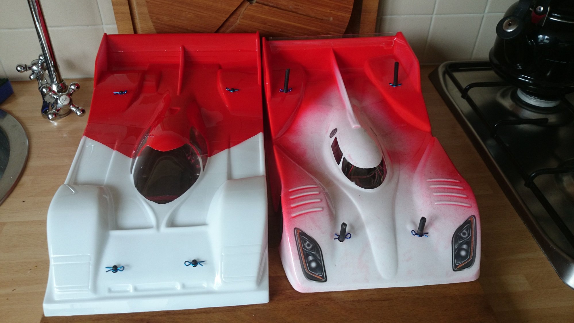

To give a idea
Originally Posted by Taz_S View Post
Do you have a ruler so we can see the measurement of the front of the Mix Nissan body?
Pro10noob is offline
