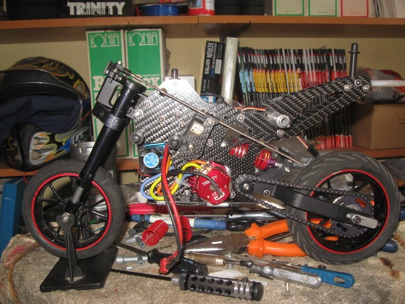

I converted my 1/5 rc bike recently, from KP09 model to KP10...
What prompted the change was a broken chassis plate, and since they are being sold in pairs, I said what the heck, let's do it a 10. This involved getting a new swing arm as well, but presented me with a slight problem: The chassis plates leave a space of 25mm between them, while the old one left 30mm.
So, here's how to squeeze a xerun 60A ESC inside the plates AND keep the fan:
(And, yes, the servo is a vintage S9401!!! Since it works flawlessly, why not?!)
I actually removed the fan from the ESC cooler and enlarged the brake servo opening on the left side chassis plate so that the fan air can reach the cooler.
This is how the fan sends air to the ESC:
and...
I could have mounted the ESC on the outside of the left side chassis plate, but it would be: A. vulnerable to crashes and B. placed a lot outside the inline center of the bike, not to mention I would probably have to run it without a fan, which I really don't want, since summer is almost here... sort of!
I even managed to squeeze a cooler on the motor, by just trimming some edges here and there!!!
Since I am running stock class (17.5T motor, 1900 gram. weight limit, no front brake), I didn't really care to leave the space reserved for the front brake servo free! It's the lower cutout, where the fan cables and the blue cable enter the chassis...
I still have not tested the new chassis, which included a new headstock, too, because I'm missing some small but critical parts to complete the conversion.
The FW installed though is already the latest, with the lowest of the recommended settings for 17.5T onroad, and will see from there on...
But this will be posted in the other thread!
