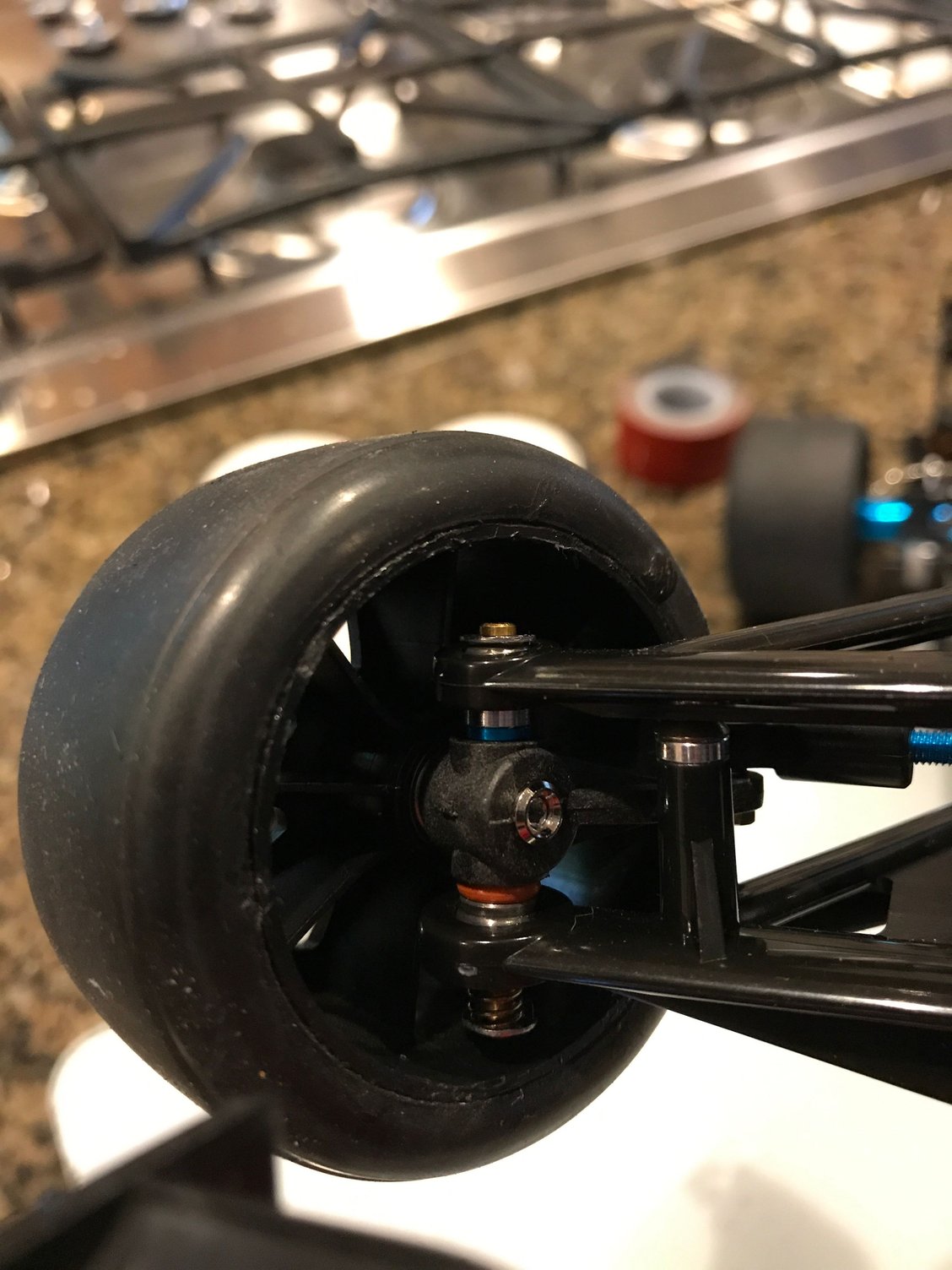

I cannot get ride height on the front over 4mm. Is it advisable to run without the rubber o rings below the steering knuckle? That is the only way I think I can get up to 5mm ride height.
you do not need the o-rings use the set screw to hold in place. I have never seen or used o-rings on my f104’s

I saw them used on a photo from a few years ago. They act as a kind of up stop cushion...the car gets less unsettled coming out of a bump/chassis stays a bit more settled through transitions.
That’s the theory, anyhow
seems to have worked well.
I did see one issue w my ride height. The kit fronts are taller than tcs/crc fronts. I will try it without he orings if I need to get up higher for one of our more uneven asphalt tracks. Thanks
Like f1Larry said, I’ve never seen o-rings innthat positition before. I’d start by removing those. I’d also remove (or get a thinner one) the spacer at the droop post/steering block. I personally don’t put a screw there, I run a longer setscrew from the bottom to adjust droop.
