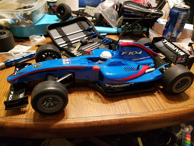

so... Here's a look at my converted F104w.
A Real Life Tinker Gnome: The f104w transformed. A f104 pro?
And for refrence, here's what it started as:
Here's the list of parts I needed to do the job:
The plastic parts - F Parts: 42289 TRF102 / F104
The kingpins - Stainless Shaft: 58431 - 3x33.4mm F104
Ball Connectors - 4mm Ball Connector: 44002 (Gold Color, 5pcs)
Ball Joints to match - 4mm Adjuster: 44002 - 6pcs
Metal Parts for the suspension - 5mm Aluminum Ball Nut - Blue 10pcs
E-clips to hold the Kingpins - E-Clip 2.5 x 6 x 0.4 - 10pcs RM01 / F103 / FGX
Front wheel bearings - 5 x 10 x 4 mm (4 pcs) - F104 Front Axle Bearing
Cap screws for the front suspension pivots - M3x6 Flathead Screw (4pcs)
TurnBuckles - 3x35mm(2pcs)
Bolts to hold the front end on - 30mm m4 flathead screws. (2pcs) and nuts M4 nut (2pcs)
Knuckles - Carbon Reinforced Uprights - F103 / F104 Tamiya (54154)
Screws - m3 x 10 (2pcs)
And I think that's it, not including the body and tires. This is really and updated list to the list a couple pages back.
