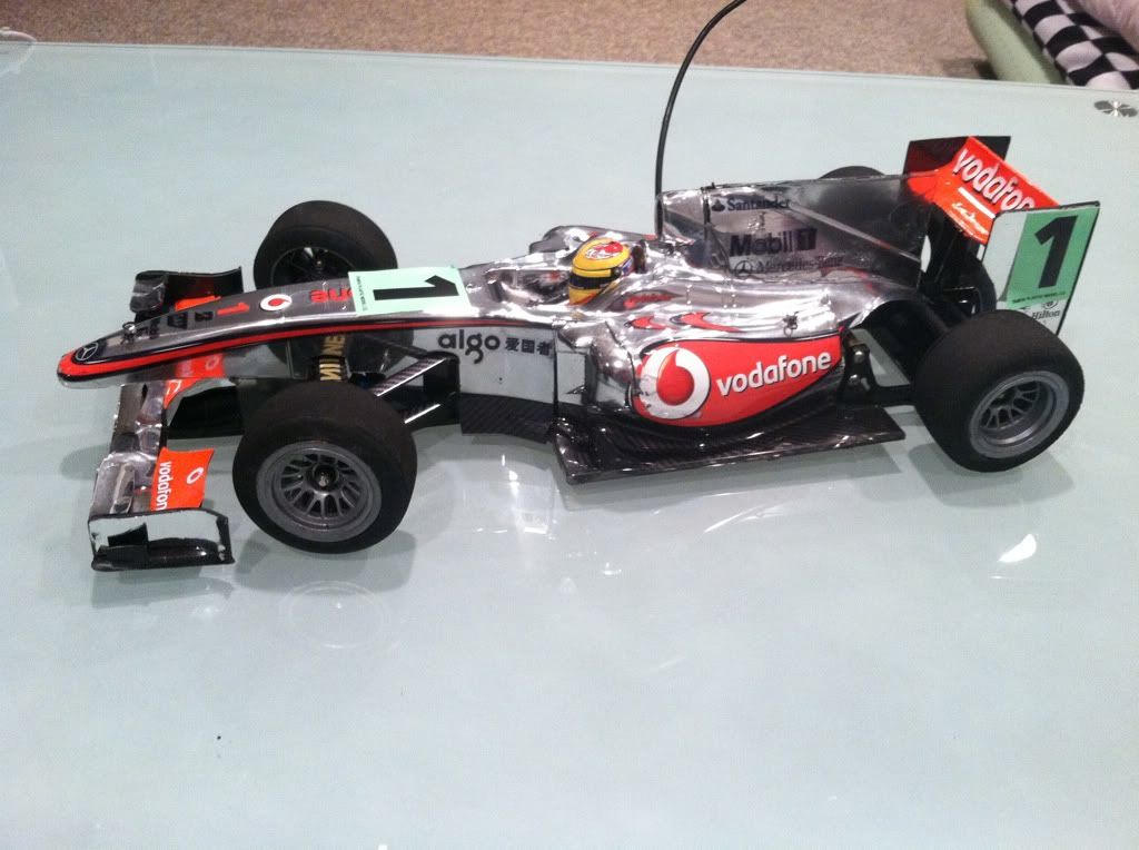

Originally Posted by k_bojar View Post
it should be the tamiya f60 body...which is what most people have been using to re-create some of the 2010/2011 team cars
It is in fact the F60, the McLaren Body is beautiful , but better for replicating the cars from 2 or 3 years ago
Here is my McLaren that I ran at the Nats
This is the F60 body with the Tamiya McLaren decals

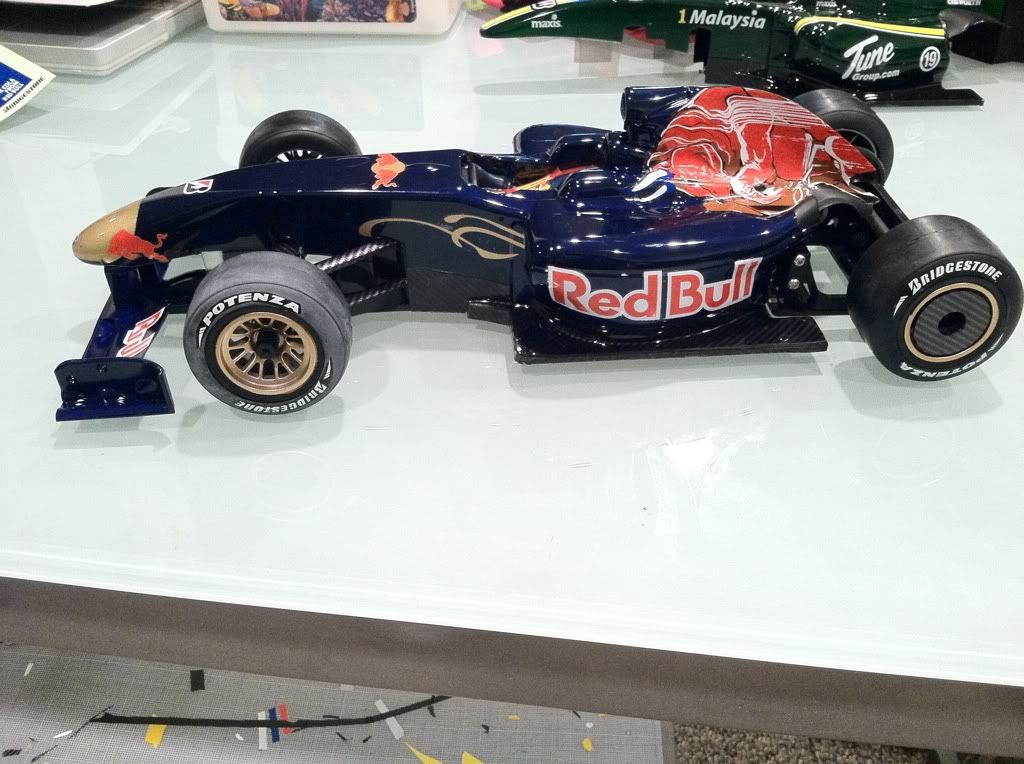

And a TorroRosso before the wing was finished.
