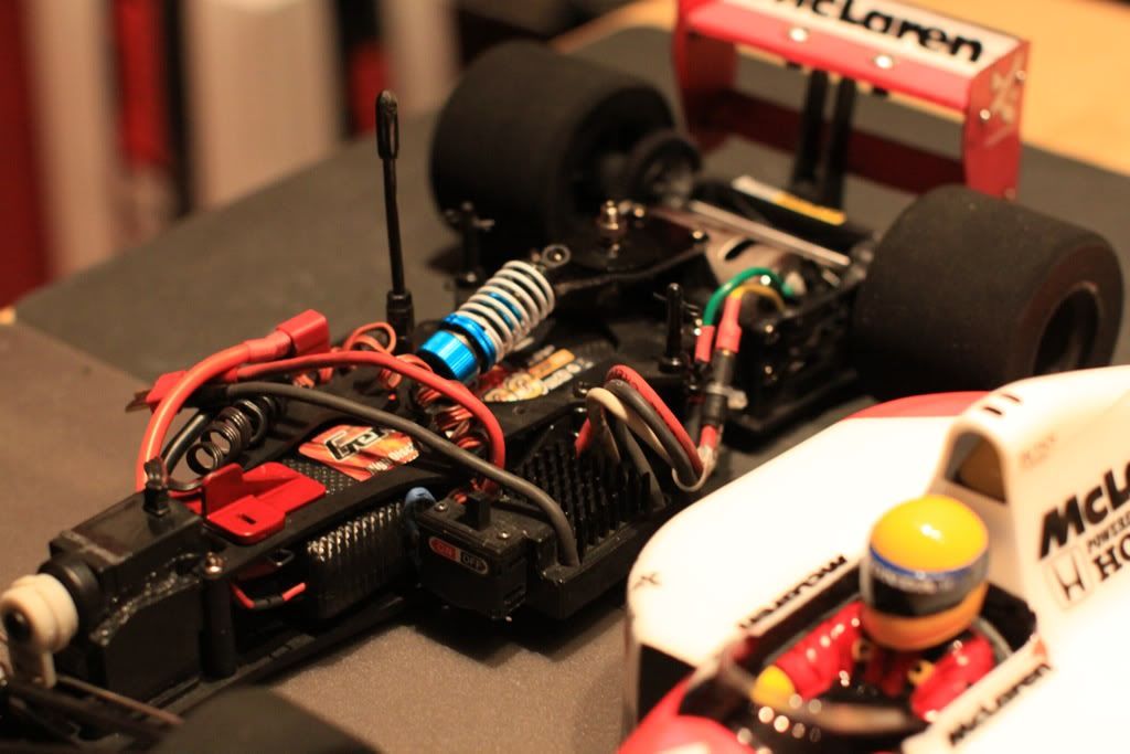

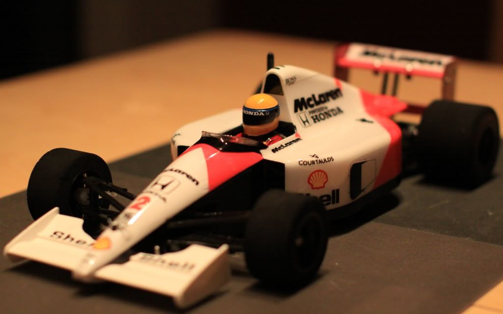

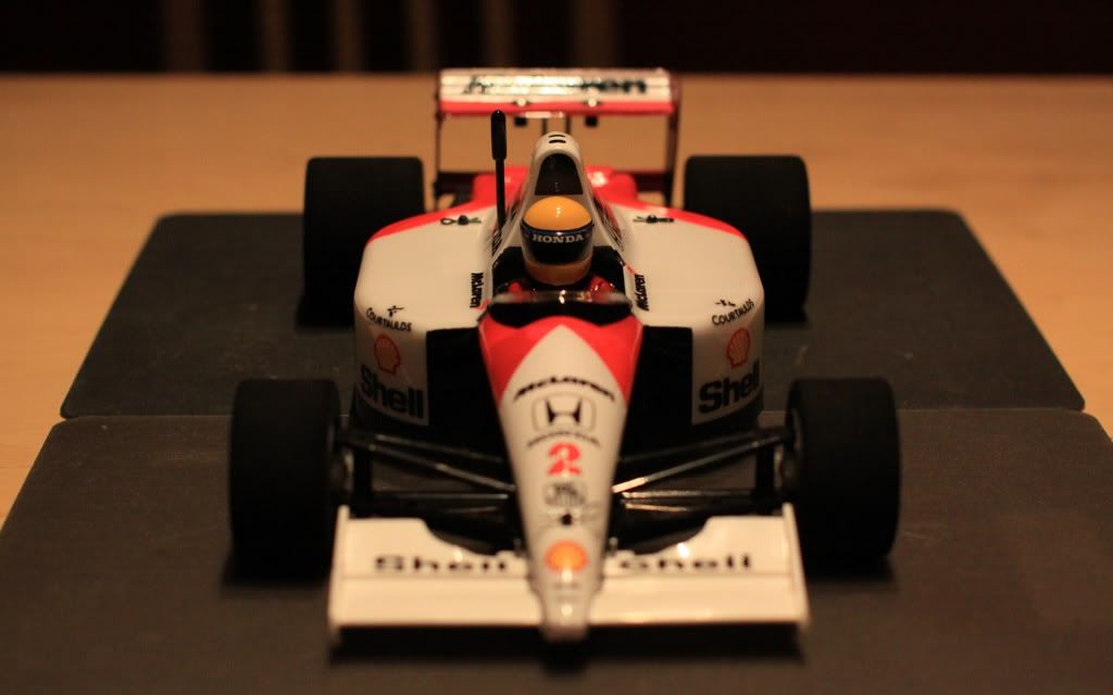

F104W - McLaren MP4/6 here. It shares parts with my F103 - which helps in the "broken parts" department if I crash. Seems pretty durable, it already had a few run ins with nor-cal hobbies' new berms.

Is the F104 just wider at the front due to the F103 suspension? or are the rear rims matching it?(F103 wheels?)
