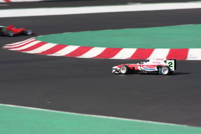

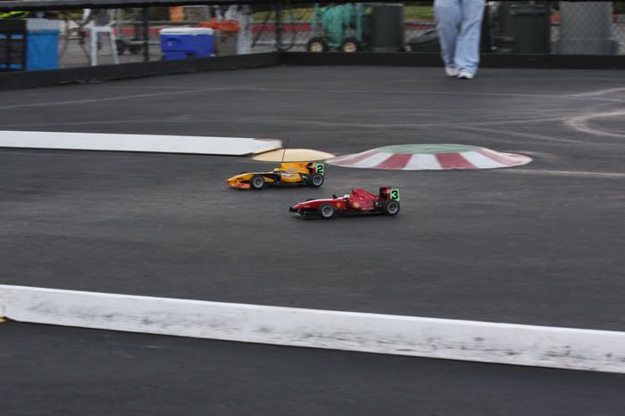

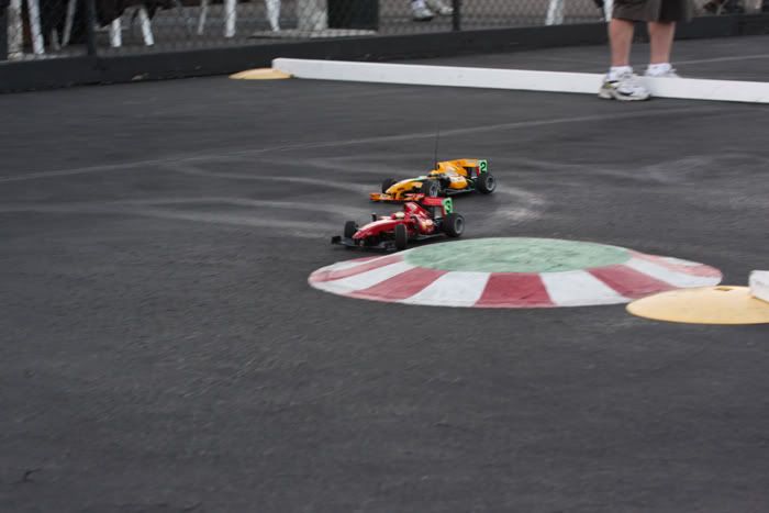

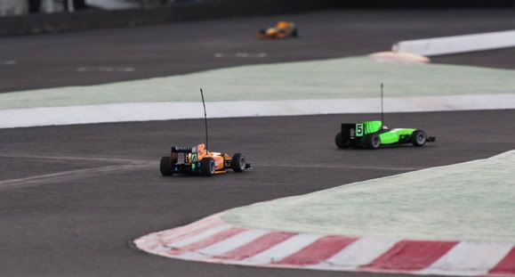

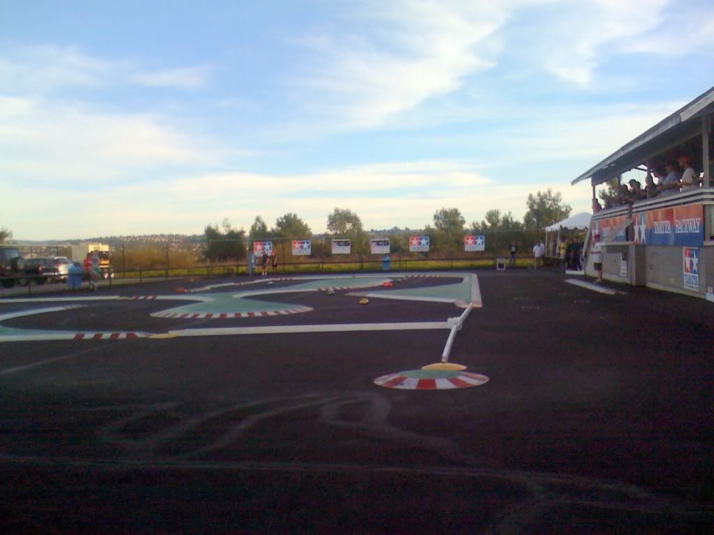

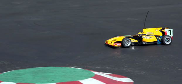

Hey guys here's a TCS F1 visual for you.
Cheers!
Marcos
Fantastic Day!
Cheers!
Marcos
Fantastic Day!
Wow those are some great looking cars. Those soft tire indicator decals, does anyone know where to get those or did the guy make them?

Originally Posted by gashuffer View Post
...Those soft tire indicator decals, does anyone know where to get those or did the guy make them?
I guess it's tire stickers from Chevron Models>>

yeah, very nice picture of the those f1 cars.
