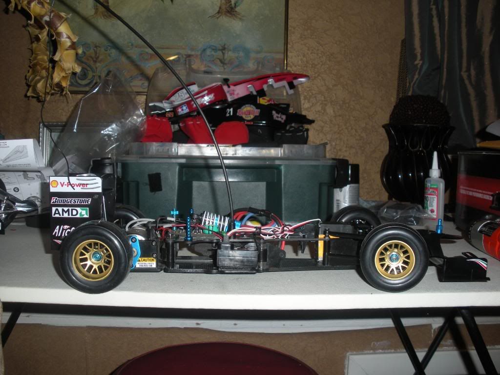

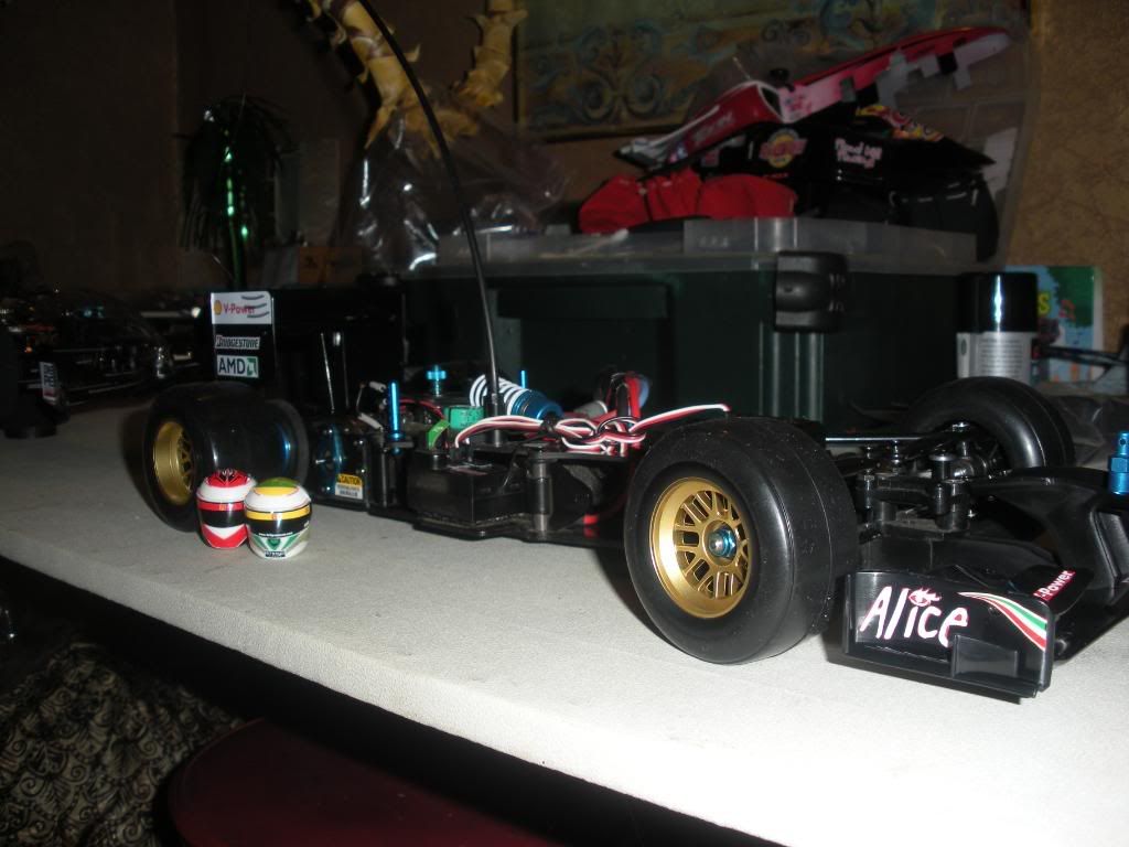

F60 in the works....

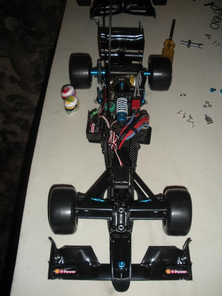

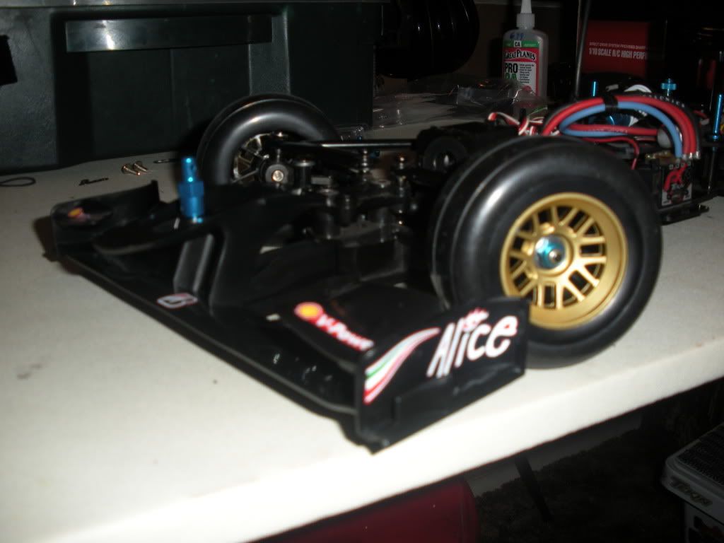

Default Progress cont...

Wow, the F60 wings are huge! The rear one looks especially large with the body off. Those two helmets look wicked as well.
I think I just might have to order an F60 body set tomorrow. As well as a set of rubber tires. Won't have to worry about chunking then.
Thanks, I plan to take my time on this one. When I get back on it, I might spend 3 straight days, but I'll take my time.... LOL.
