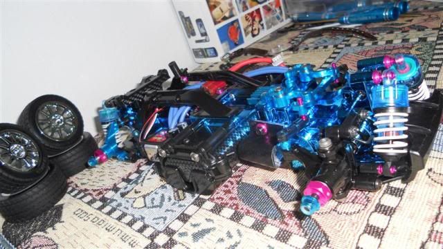

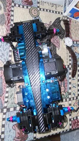

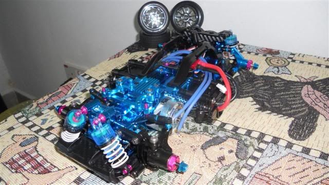

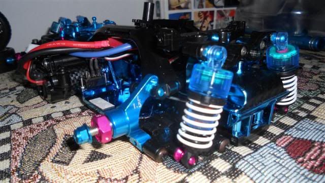

Just finished building my M05, can't wait to see what kind of pace it provides. Nope, I've never ran a FWD mchassis before (had an M04, prior). I didn't like too much blue so I got some original black parts (chassis brace, shock tower set, shock ends) and threw some PINK into the mix.
A warning to potential M05 buyers out there, the car has alot of slop. Get some shim set, for 3mm, 4mm and 5mm. 5mm ones are for the axles, 4mm for the kingpins and hinge pins, and 3mm for other misc requirements. Attention has to be paid to these areas;
None of the mentioned above are performance indicators, just wanna share my building experiences. Oh, I used CVDs in front and included the sway bar set in my ride.
