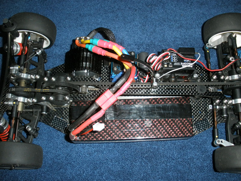

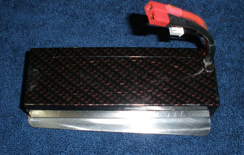

Originally Posted by timmay langdell View Post
the lipo tray wont fit unless its a 5 cell try .
We have received several requests for a solution for LiPo in the Mi4. I try to avoid "specialty" orders since they rarely pay for themselfs...although that said, if this is a simple mod like remove 1 lug from tray for 5 cell (providing size of cuttouts are close) I'd be willing to take pre orders and make a fixed qty + a few.
Using an offset pack on tray is already being done on other low clearance TC's. It accomplished several things. 1) balance with less weight since weight is further from center. 2) unlimited battery size 3) better weight dispursment since it opposes the motor at a slight angle 4) in your case gives the clearance you need for pinion / motor shaft interference.
Here's a pic of my brand X chassis, many team guys are running this way also.
On this chassis with a SMC 5000 at 10.5oz it took the 3.0 oz tray and 1/2 oz of lead to balance a mod setup. On the 009 believe it or not..their putting weight on the motor side of chassis to balance and "make legal weight".
I will have a look at Ritchies (skypilot) Mi4 on Sunday, and have a better idea on what will be required.
