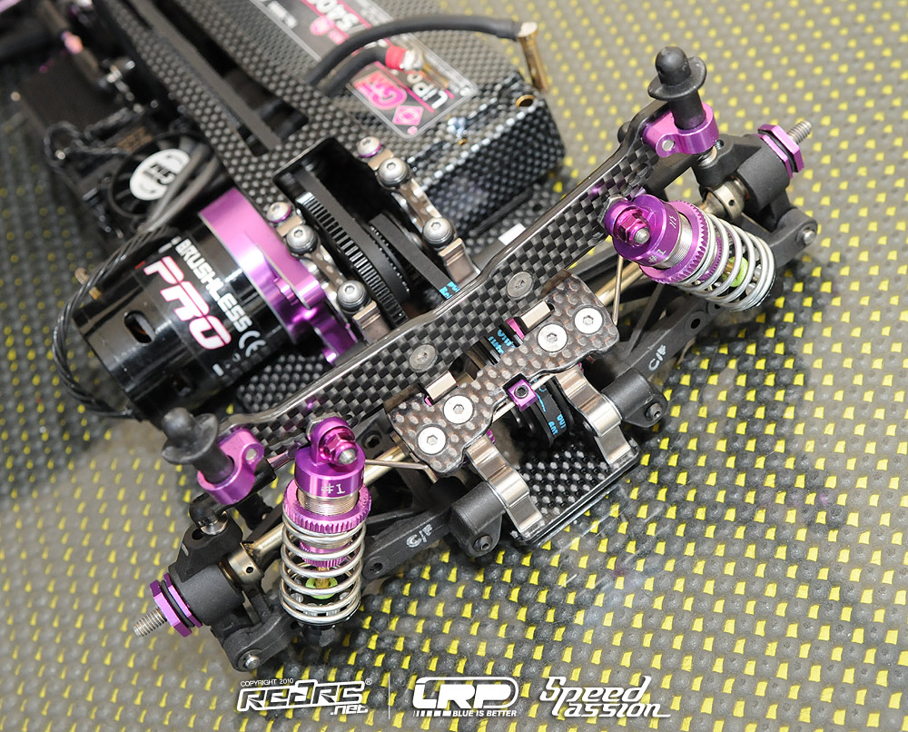

looking at chris g car it looks like hes got his pt in front of the lipo, does it realy work there? i got mine on the front bumper but if it works where chris has got it i might give it a go.
Ginge
G-mini is offline
Old 08-19-2010, 07:56 AM
  #2125
Join Date: Nov 2005
Posts: 321
Originally Posted by G-mini
Hi all
Ginge
Yes it will work fine there, many people mount theirs in front of the lipo.
Hi all
Ginge
notice the hpi silver springs. i should try those on mine.
