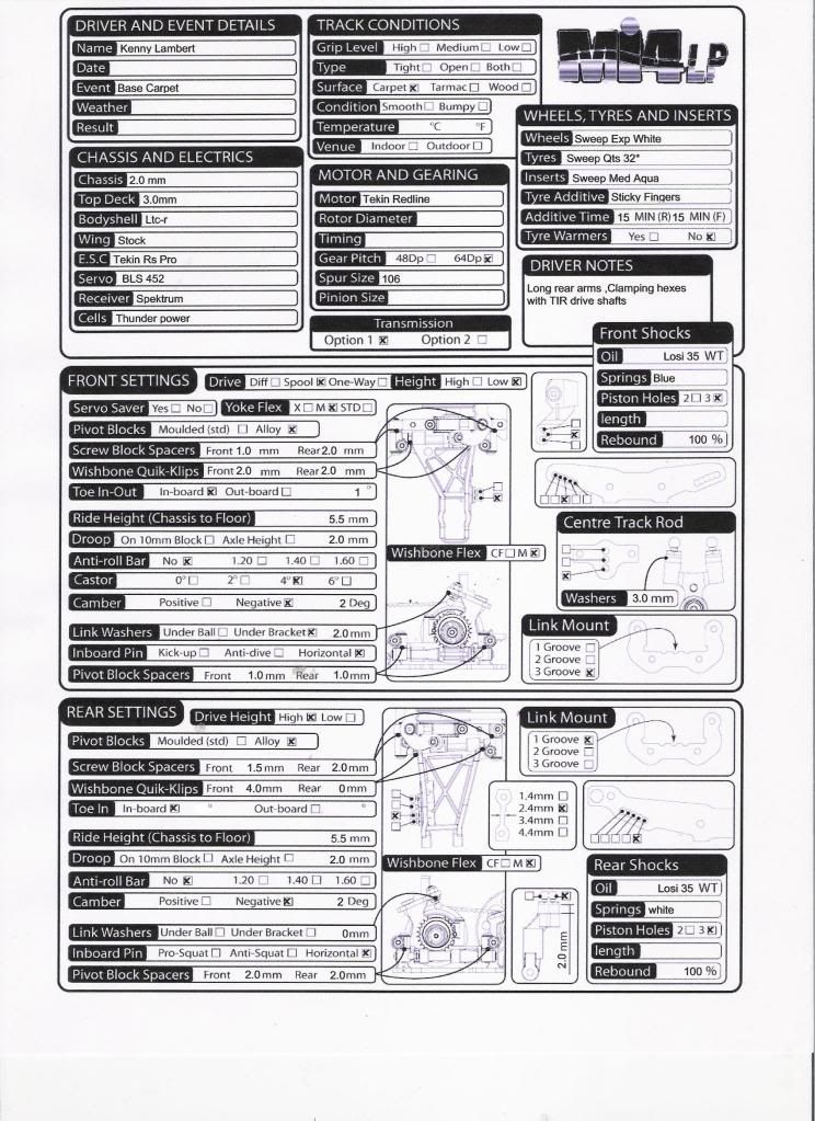

Now we are talking about arms here is setup I have been playing with last few weeks. Uses long arms in rear

Kenny what flex compound are you running?

I'm running med flex ones like the rear bite they give me. Not big fan of rear shorts for carpet because the shimming needed to make width makes weaker around bulkhead and hinge pin mounting area. I rather break an arm not pivot blocks or bulkhead screws in bulkheads but thats just me

I see it now on the sheet, I check the screws often to make sure their not bent, for asphalt I tend to run the car narrower anyway.

Thanks for setup Kenny, is there some interesting ideas, this for low grip?
I think to test, in small, low grip asphalt track. I see similar things to our asphalt setup.
I have a good base setup, for long, medium grip asphalt tracks.

Luis,
this setup will be pushy in low grip. Funny thing is its not far off what I'm running in asphalt either. Body, top deck, drop and toe are only things I change for asphalt .
