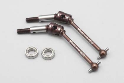

I read the wiki, but the mira outdrives are discontinued . . .
is the only option to go with the Spec-R shafts?
+ 1
Also has anyone tried the Yokomo DJC? Pic below. Part No. BD-010FW

Originally Posted by mazmo
+ 1
The ball and pin are bigger then ours. You can make it fit but will require some modification of our outdrives.
TOP DCJ's are coming. About 3 months away.

Just an FYI until the top DJS are available the arrowmax ECS shafts for the Tamiya 416/417 work perfect in the photon and the EX. They work with a slight dremel mod on the stock C-hubs, and still use the stock steering blocks and king pin collars. The best part is they work with the stock spool drive cups or the steel ones. And they take no CVD Blades. You just need to use 5x10x3 bearing on the inside of the steering knuckle
Got TONS of packs through my car with zero problems
