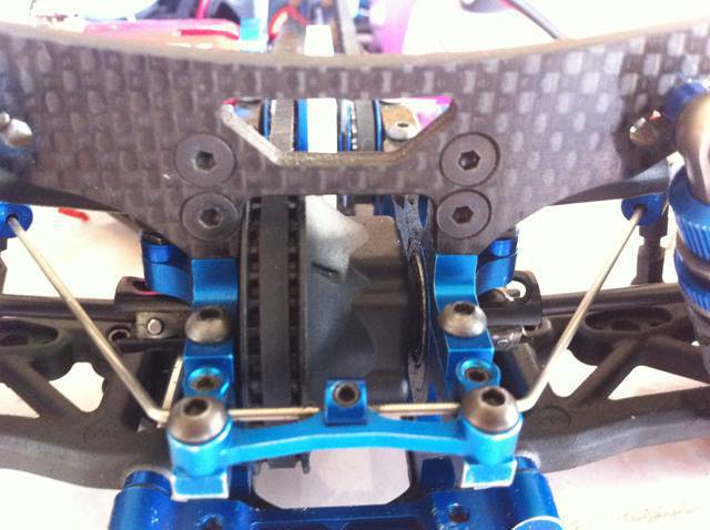

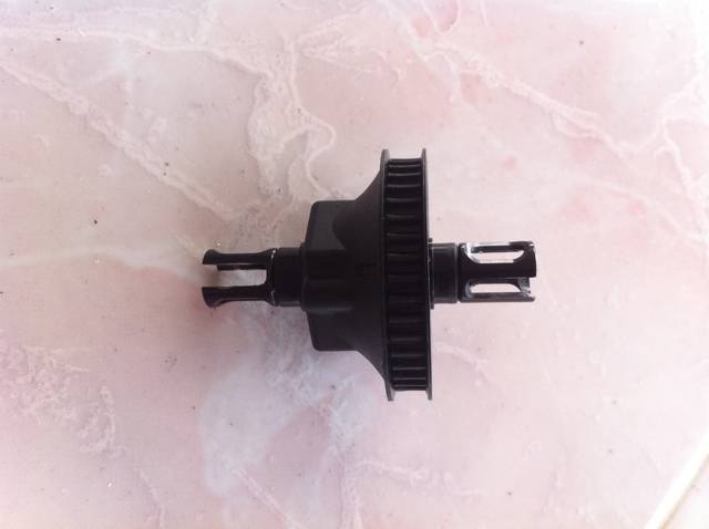

Spot the difference?
Im using Xray Hudy Spring Steel Outdrives For Gear Diff. Works well so far.
No modification needed. Just plug and play.

^no leaks?

To do this properly you need to be using 50mm Xray rear driveshafts, and Xray blades otherwise the standard driveshaft would wobble around a lot inside the outdrive. The ball end is much bigger on a xray driveshaft even though the blade diameter is the same.

No leak. It just nicely fit.
I think no need to use Xray driveshaft. So far Im using Yokomo driveshaft with SpecR/Xray blades with no problems. But I haven't try using Xray driveshaft as you said. Will try it soon
