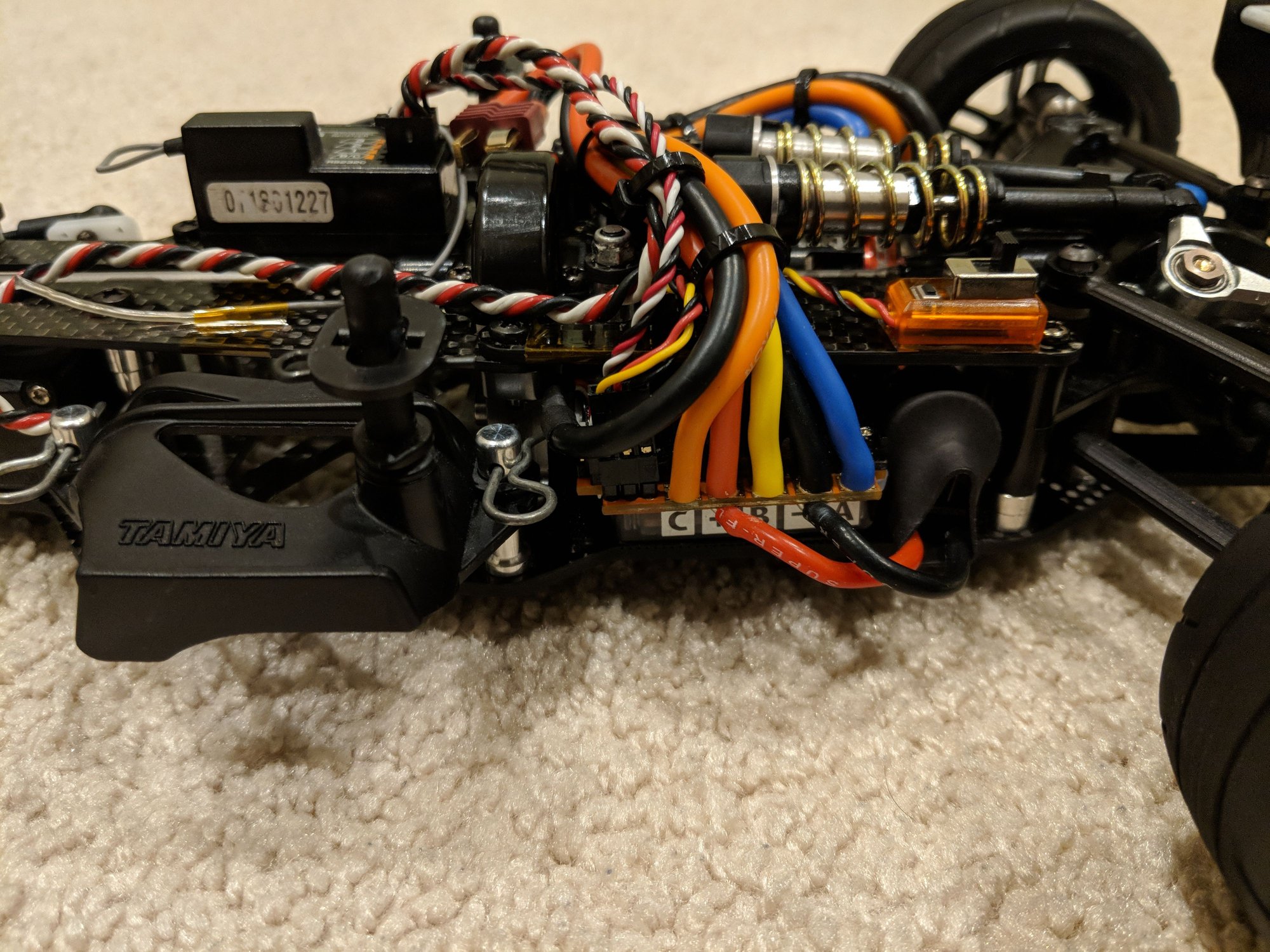

Took out the stock brushed motor and esc and replaced it with a 10.5t Gen 3 Tekin and Novak GTB2 I had in my parts bin. I have the absolute smallest pinion installed and even with the NiMH pack it is really fast...I may limit my max throttle setting to stay out of trouble
The motor bairly gets warm and the battery us much cooler. I also like that my GTB2 brakes are much stronger than the one in the Keyence A-07R.
