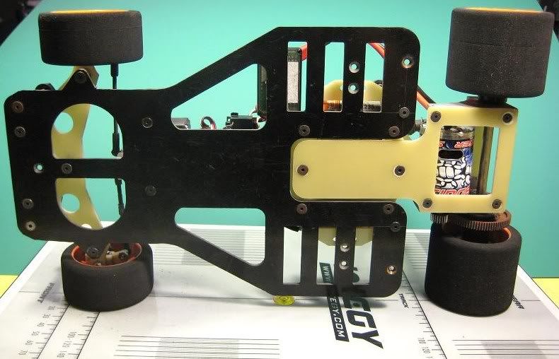

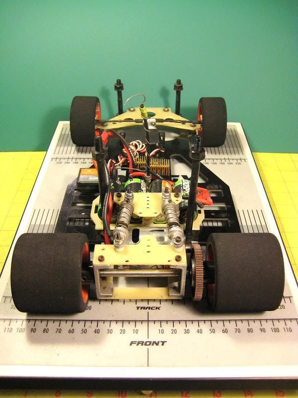

Remember the old Bolink Eliminator 10 from WAY back in the day?

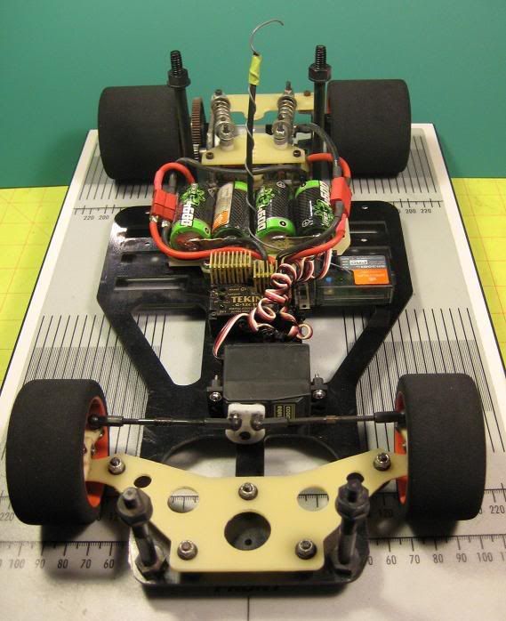

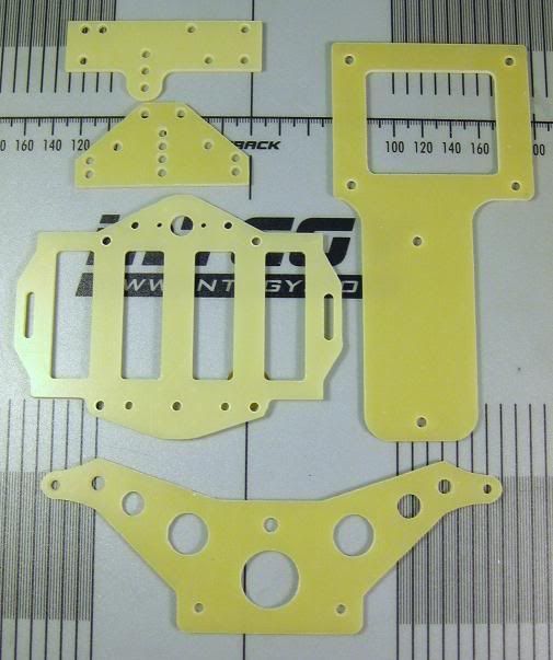

With the resurgence and development of 200mm pan cars and the current World GT rules specifiying 4-cell battery packs, i thought i'd try to design some new parts to convert the 235mm Eliminator 10 to a 200mm car capable of using 4-cell battery packs.
Why? They are still being bought and sold on ebay. Does it seem kinda pointless considering the current quality of 200mm cars? Eh, maybe. It was a good exercise in drawing up parts and sending the files to my brother so he could cut them on his CNC machine.

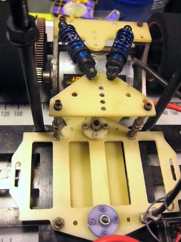

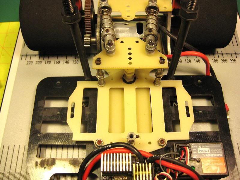

The part i'm most excited about is the redesigned radio tray. I designed it to hold the 4-cell battery back. I also designed it so that a person can modify it to accept the AE pivot ball pieces from the old RC10L series of cars.
The t-plate was narrowed so the rear wheelbase is 200mm. The fore and aft shock mounts have several holes for various shock mounting options. Let's face it, the old shocks are, uh, old. I've seen several ingenious replacements that can utilize the various holes.
The front axle plate narrows the wheelbase to 190mm. That requires some cutting and drilling to the old chassis, but nothing too extreme.
All in all, i'm pleased. Once i dye the parts black, i'll be VERY pleased.

Very cool project man...surprised you didn't use saddle 4 cell though and just use the default slots...that would keep your CG lower.

True... plus with the 3 slots on each side i can place the weight where i want. My thought process was, "How often do you see 4-cell saddle packs these days?" While not overly difficult to make, i HATED soldering them up and transporting them.

Just dyed the parts and they turned out pretty good. Would rather start with black fiberglass, but this worked out.
Here's the formula i used:
1- 8 ounce bottle of RIT dye
7 cups of water
1/2 cup of salt- not sure what salt does, girlfriend said that's what she does when she dyes clothing.
Let simmer for about 1 hour.
Now the problem with dying so many flat parts (i made 5 kits) is that they lay on top of each other and can impede the flow of dye. I need to come up with a way to stand them on edge to be dyed properly. The nylon test pieces from an RC10 came out awesome.

Took my own advice and drilled out the battery tray to accept pivot balls.
The difference in handling is like night and day. My litmus test is the street in front of my house. If a car can maintain any semblance of traction there, it should do pretty good on a prepared track with some tire sauce.
Prior to the pivot balls it was like driving on ice, zero traction. Now that the rear end can roll side to side, traction has come up. I switched the rear shocks to some RC18T front shocks i have for another project. Sadly, i have no local track so i can only test on local parking lots and tennis courts. I might have to make a few road trips to test this thing out.
