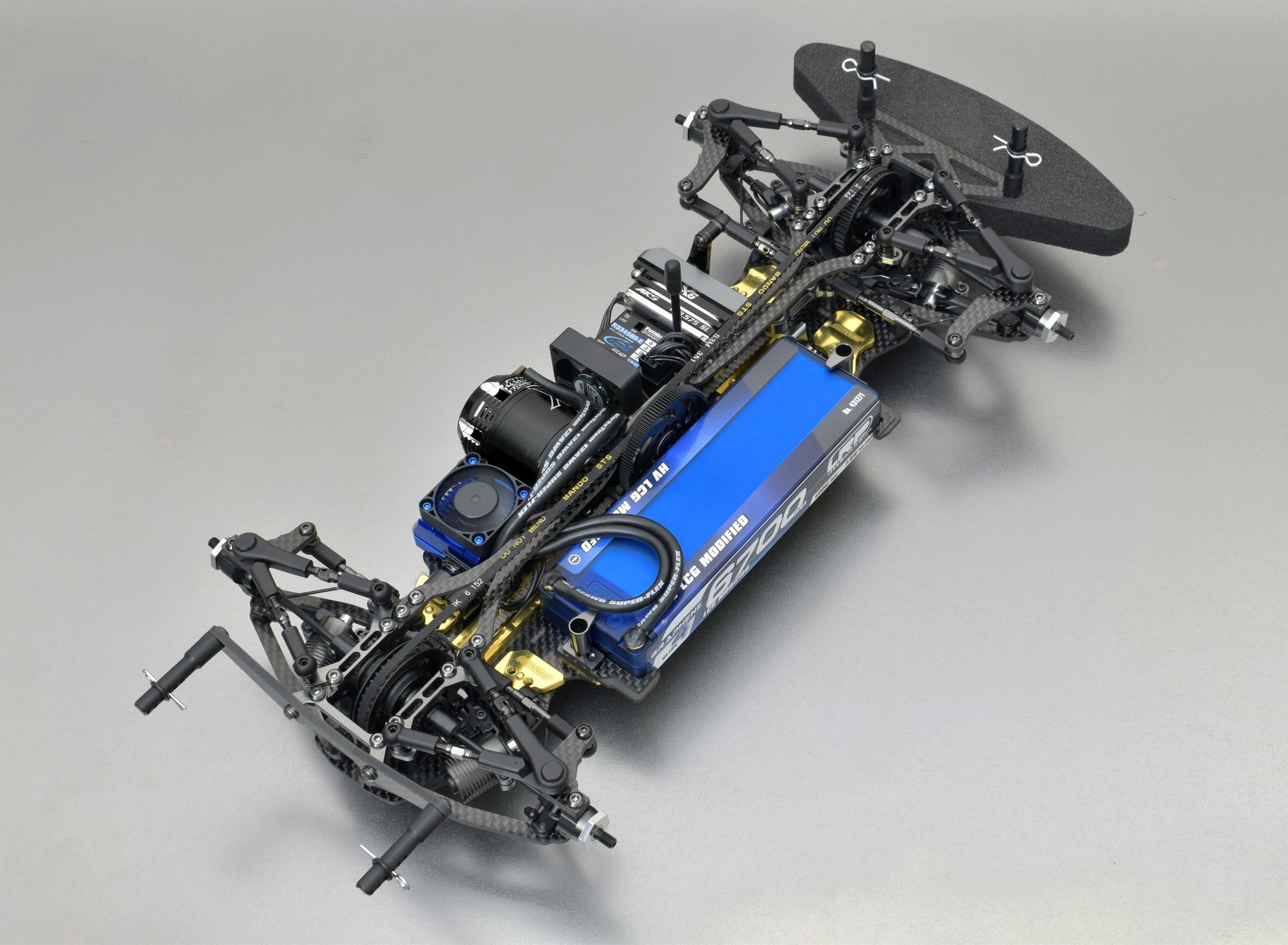

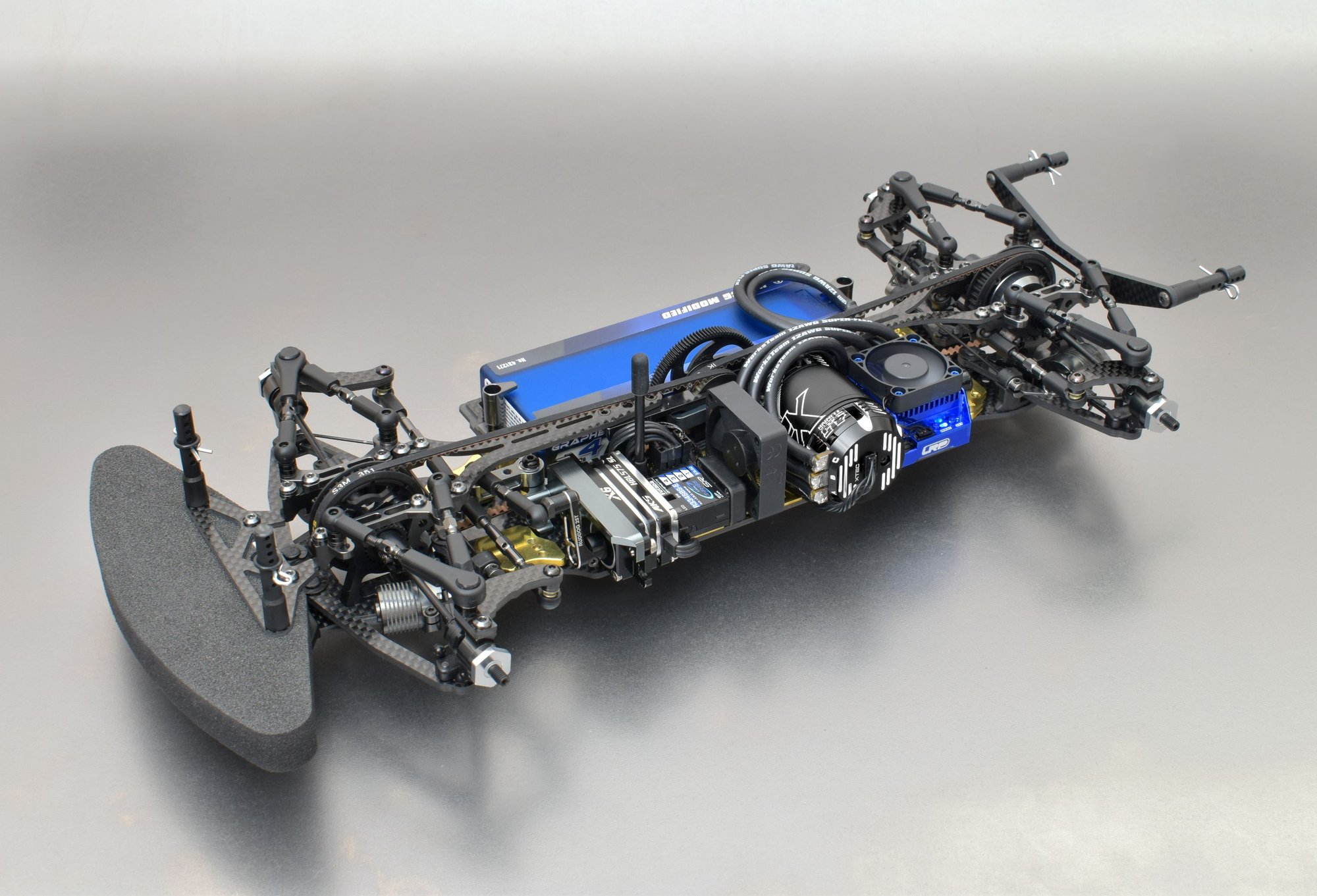

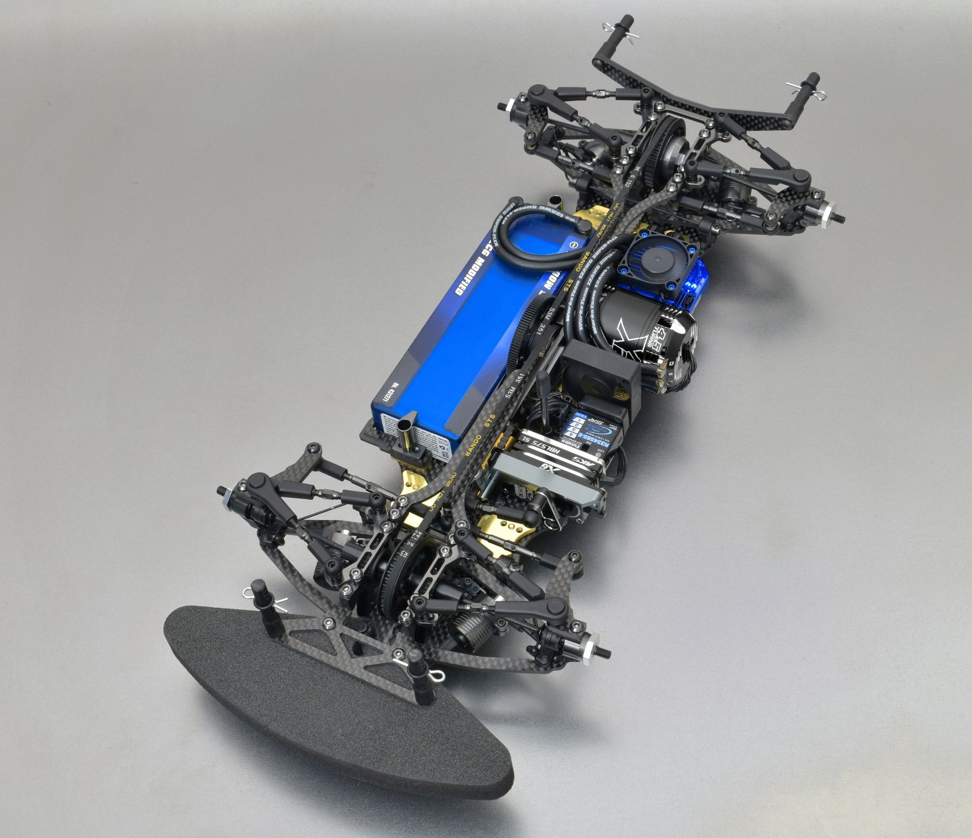

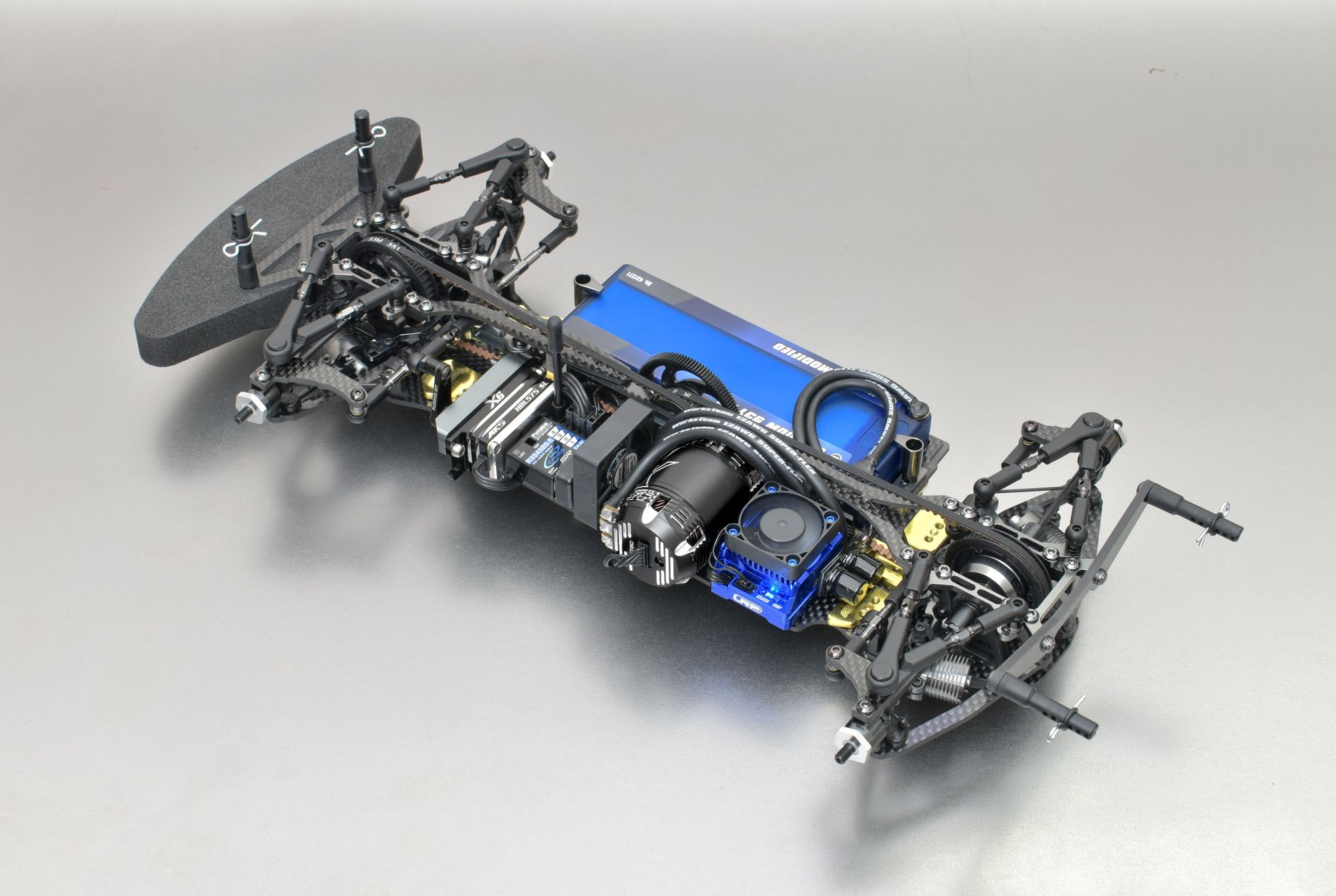

Here is my latest work:
nice wiring bro , quick question for ya . How do u run the esc wire to the receiver ? Under the motor?

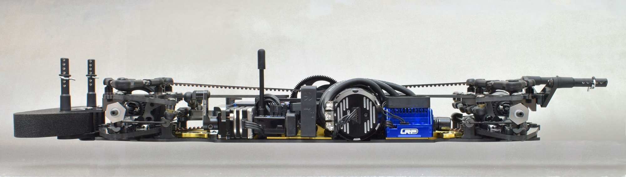

Hi there,
No there is no space under the motor. It sits flush with the recess of the chassis. Only motors without aluminum sleeve on the stator (i.e. Hobbywing, Performa, Reds etc..) may allow a wire to pass under the motor.
I extended the receiver wire on the LRP speedo by replacing the one it came with a much longer one and placed both sensor wire and receiver wire under the 3 motor wires.
In a way I arranged the motorwires to this direction in order to hide the other two wires and also allow for a neat parallel orientation of the 3 wires.
It is visible on the 'floating' side shot.

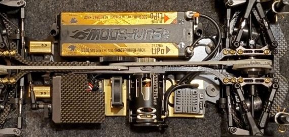

Yo
u can see the rx wire running into the notch around the front of the motor in my mmx. Like Mike said, the notch is small, but you can still fit the rx lead through it. The chamfer on the front of most motors helps to provide a bit if extra space too.

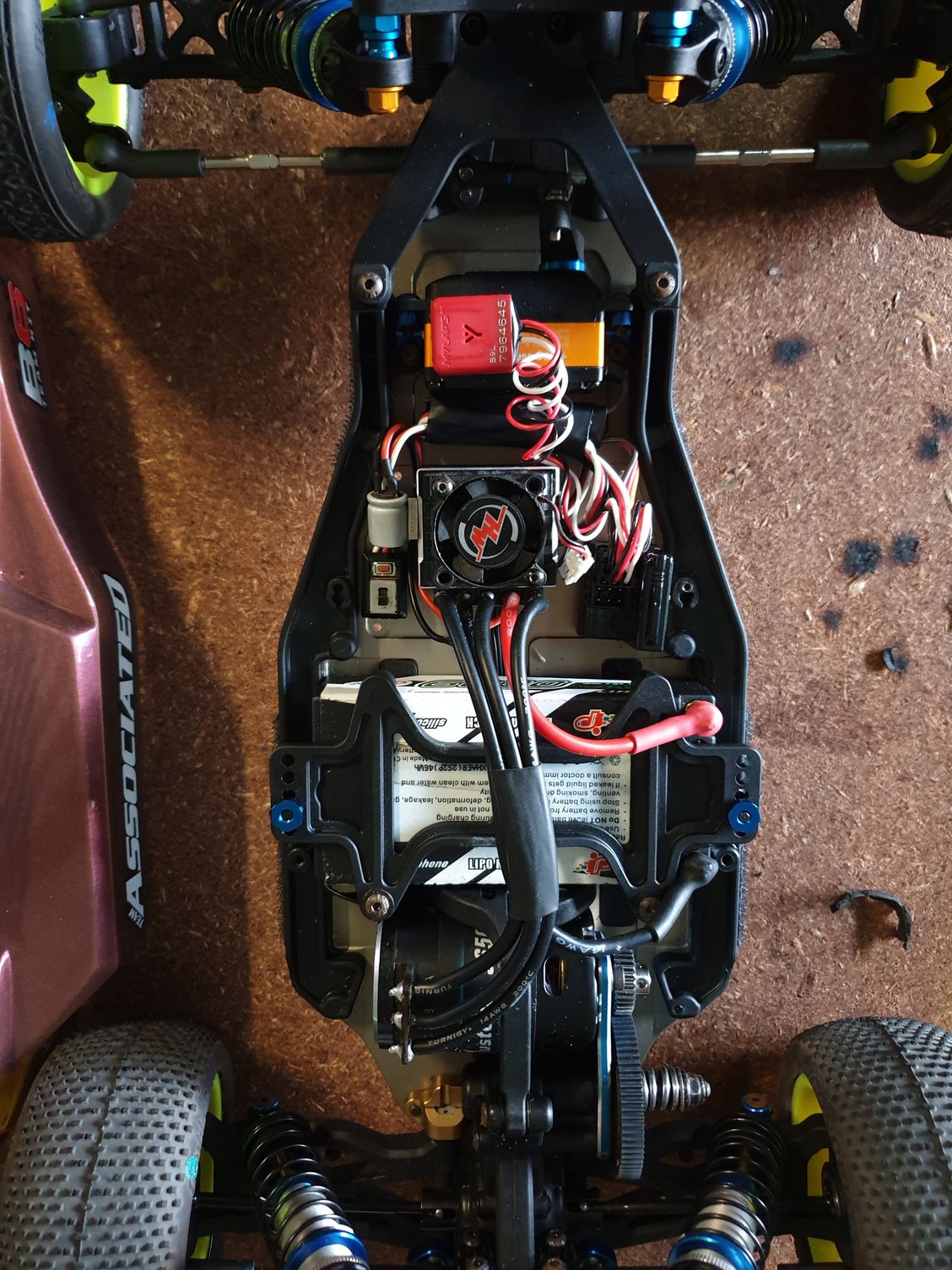

Some dead set works of art on here. Plenty to aspire towards.
This is my first attempt of "neat" wiring on my daughters buggy. Need some work on transponder and receiver wiring, think I'll start shortening wires. 3 more buggies to rewire and then see what I come up with on a 1/10 tc and 1/12 pan.
