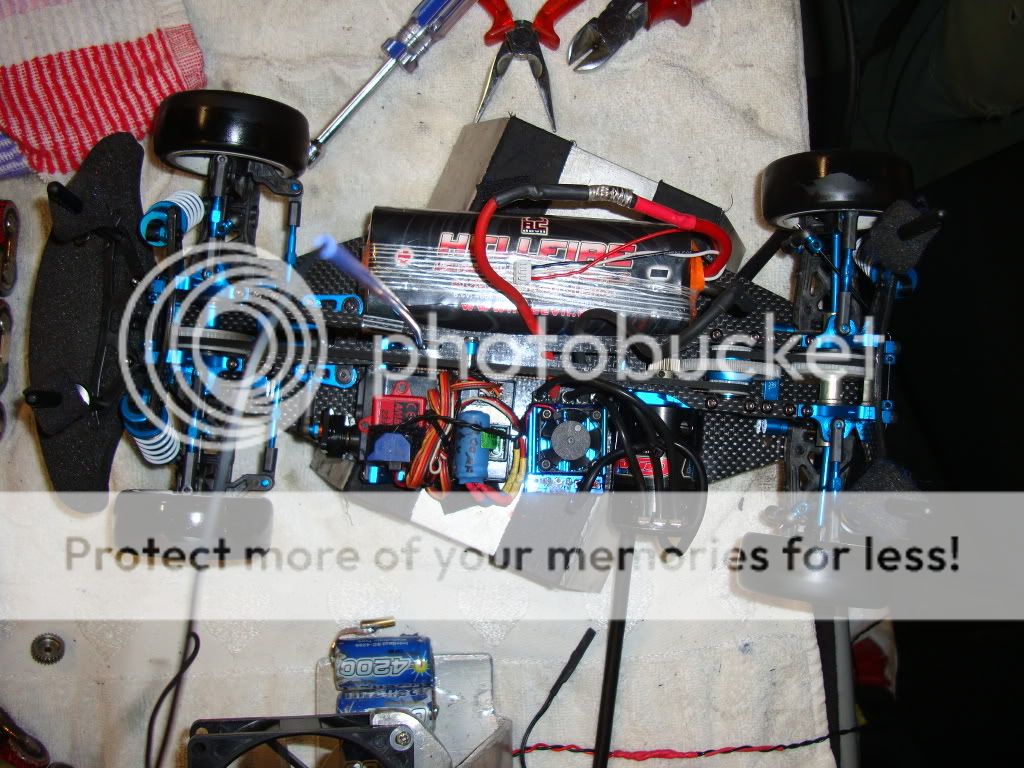

Hi again,
Promised you guys a few pictures. I was only able to take some pictures of my TRF416. The overall fitment could be better, because I should redirect my wires. Now they go underneath my topdeck, but they should go over it. They should actually go through the hole in the topdeck. Anyhow, I just made 2 photos showing the configuration. Still no weighing opportunity and no voltmeter has been used yet. Due to the fact my motor broke down and I called it a day. Still managed to take some pictures though.
I know my wiring could be much better, but my whole setup is in an experimental phase, so I have to clearify my bad wiring!
