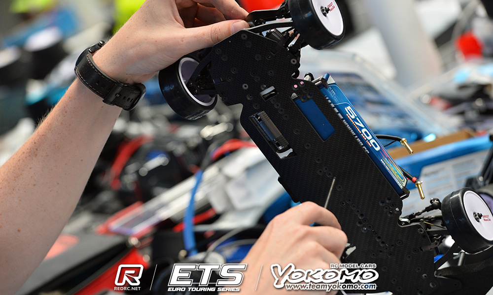

ETS @ XRay's factory this weekend. Viljami won 13.5 last year.
http://ets.redrc.net/2013/06/chassis...jami-kutvonen/
Good luck to all of the runners there this weekend!

Updated Raceberry chassis? Or new Awesomatix one
I suppose Freddy is using a central stiffner, I hope we will have more detailled pictures during the weekend
Speaking of updated parts, may I re-ask my questions ;-)
that is the raceberry v2.1 chassis -- just become available.
i suspect Oleg might be at the race ... so you're questions will have to wait.

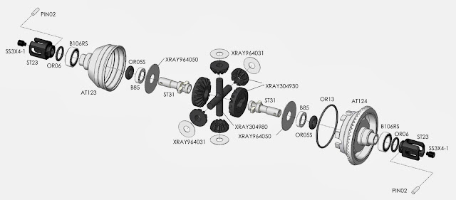

GD2 + Shepherd Gears
Just had a chance to build up 2 new GD2 with the Shepherd Gear set.
I was surprised how much fitting was needed to get a super smooth diff action.
Normally standard fare to smooth sand the backs of gears but this is what I needed to do to get the Shepherd to work well:
  • Removed the shims behind the small gears
  • Sand the backs of the small gears
  • Sand the fronts/backs of the big gears
  • Wire brush out the teeth of the big gears
  • Fill and bleed with the shock pump
It wasnt so much the work needed - just that it needed that much fitting. Havent had similar issue with Xray or Awesomatix gear sets.
Difference in experience?
All I had to do was not run the shims behind the large gears, no other work needed and they are plenty smooth
From the Shephard gear package - did you used the single big flat washer behind the big gear or the Xray part?
I used the washer from the Shephard package as it was washer for backing the ST31. The GD2 kit doesn't come with that washer.
