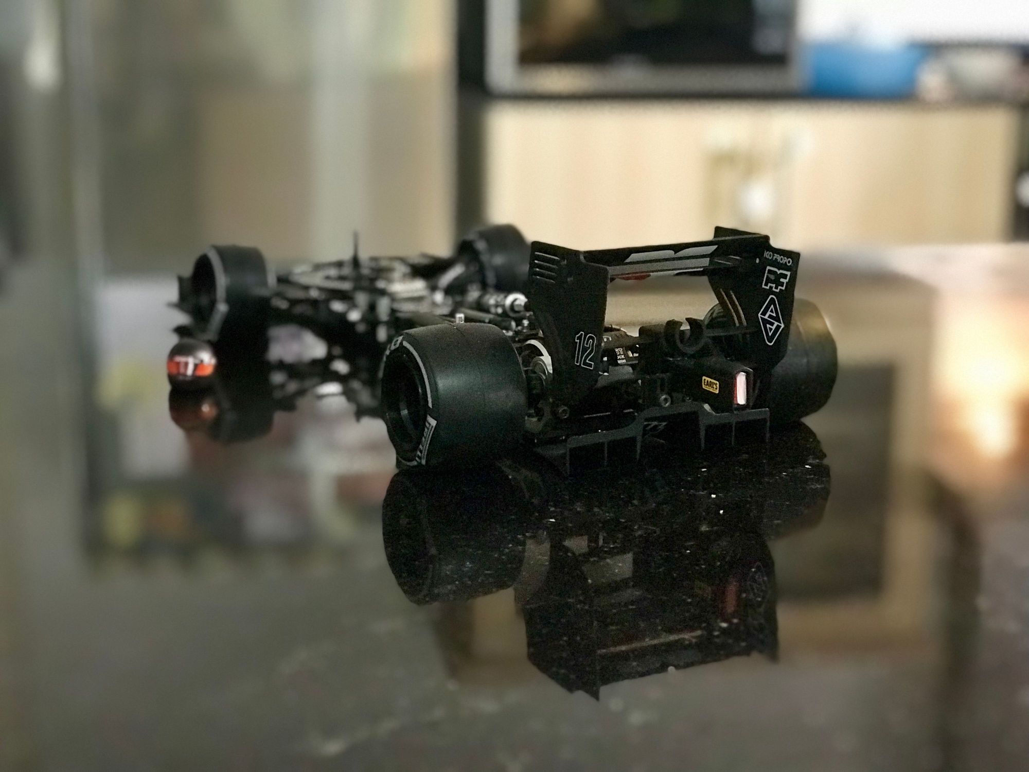

TRG 117 chassis with electronics and wiring sans the Mercedes W07 polycarbonate body, in different angles.
Pardon the influx of photos. There is no specific TRG thread so nowhere to post and share stuff but here.

Share all you want, brother, share all you want.
Moar close-ups, please!

I would be interested in seeing a good close up of the front body mount and knowing if it is something particular to that chassis or could be used on other cars as well.
