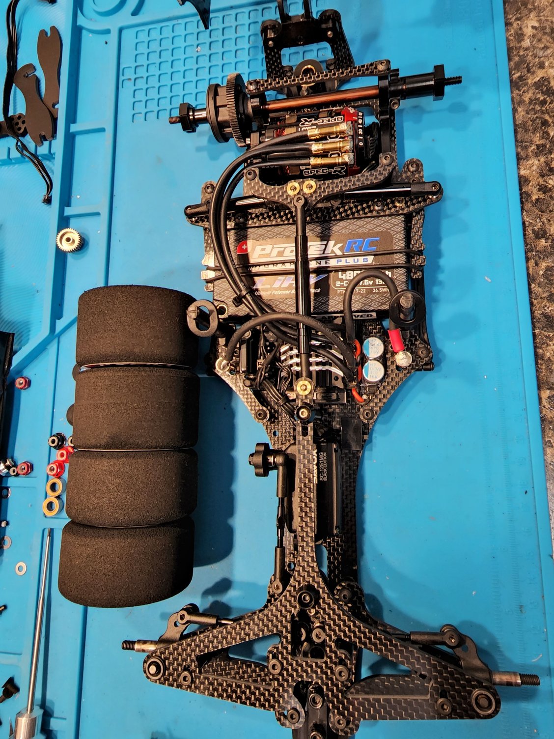

So I ran the foam tires this past weekend approximately 147 laps. These are the contact F1 foam tires. As you can see they have less than a tenth of millimeter of wear on the front however the rear did lose 1.2 mm. they still retained their rounded profile and they worked incredible ...most of the guys who watched the car run we're saying WTF why don't we just run these.... Yes they are that good....

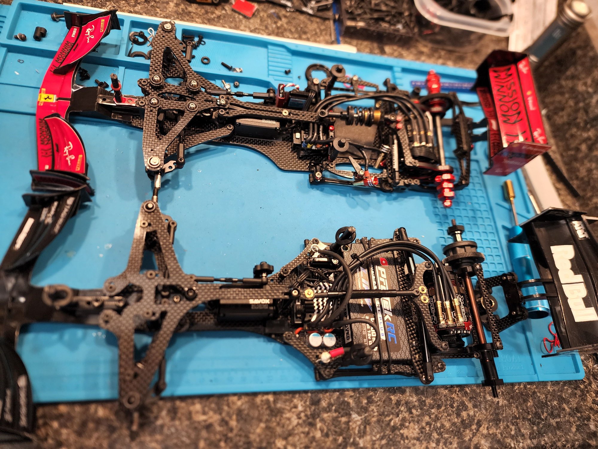

I have been running two cars
​​​​​​The icon 2 and the EVO 3. I have been testing several tires using both chassis to see what kind of difference they will have. What I have found and another driver confirmed is both cars run equally well and I can post lap times within 1/10 of a second between the two chassis using the same tires.

Thanks for the feedback, which shore combo did you test?

may need change between left and right for each or two battery, for both, front and rear

I was using 45 shore in the front and 30 in the rear. Yes I am rotating the tires between the runs same as I do on 12th scale. I honestly can't believe how well these tires work no traction rolling at all. Just smooth constant grip. We had tried the matrix tires but they were causing traction roll I think it's because of the profile of the tire the contact have a nice rounded profile The matrix have a squared profile.

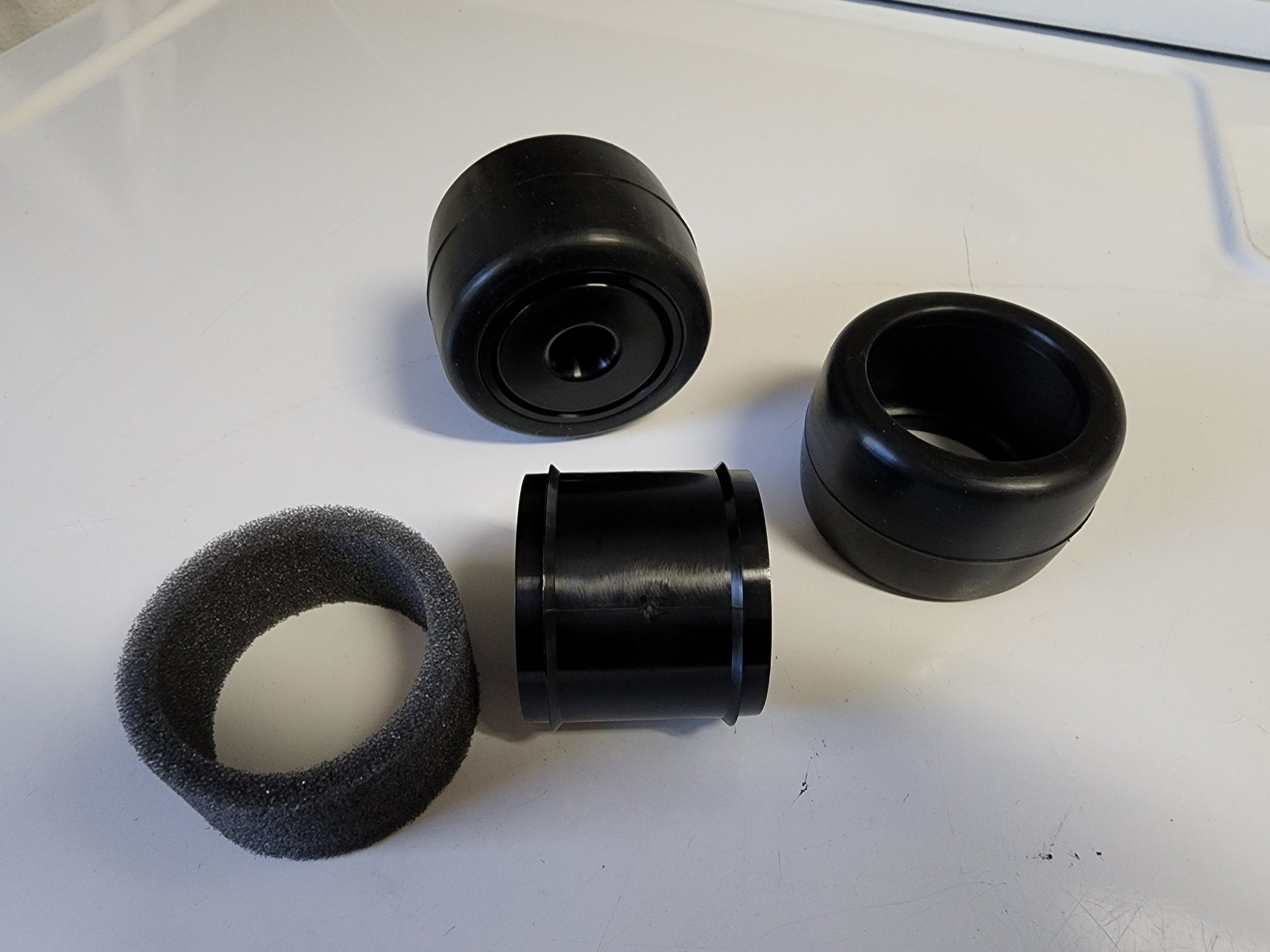

Exotek F1 tires and wheels are here ....first impressions are they're very nicely made. I really didn't want to glue but they mount up just like 1/8 scale off-road wheels with a groove a few millimeters from the edge of the rim so the tire sits really nice on the rim. They have a nice soft foam insert and the design of the wheels is really nice very rigid. I can't wait to get these on the track.
Vent holes are already pre-drilled in the rims. I like the 2022 rim styling.

I heard front diameter is near identical to Pit Shimizu tires and the rear is only slightly smaller in diameter. Is that true? Anyone confirm diameter measurements?

That being said, the Exotek tire looks like a winner just based on design. Like the Pit and Hudy tires, there is a higher profile sidewall. These cars work based on sidewall flex. In fact, if you could decipher the old pit shimizu tire charts, beyond the actual rubber, softness was also based on the thickness of the rubber. 572 and 575 were the same compound, but 575 was thinner rubber, and more sidewall flex.
