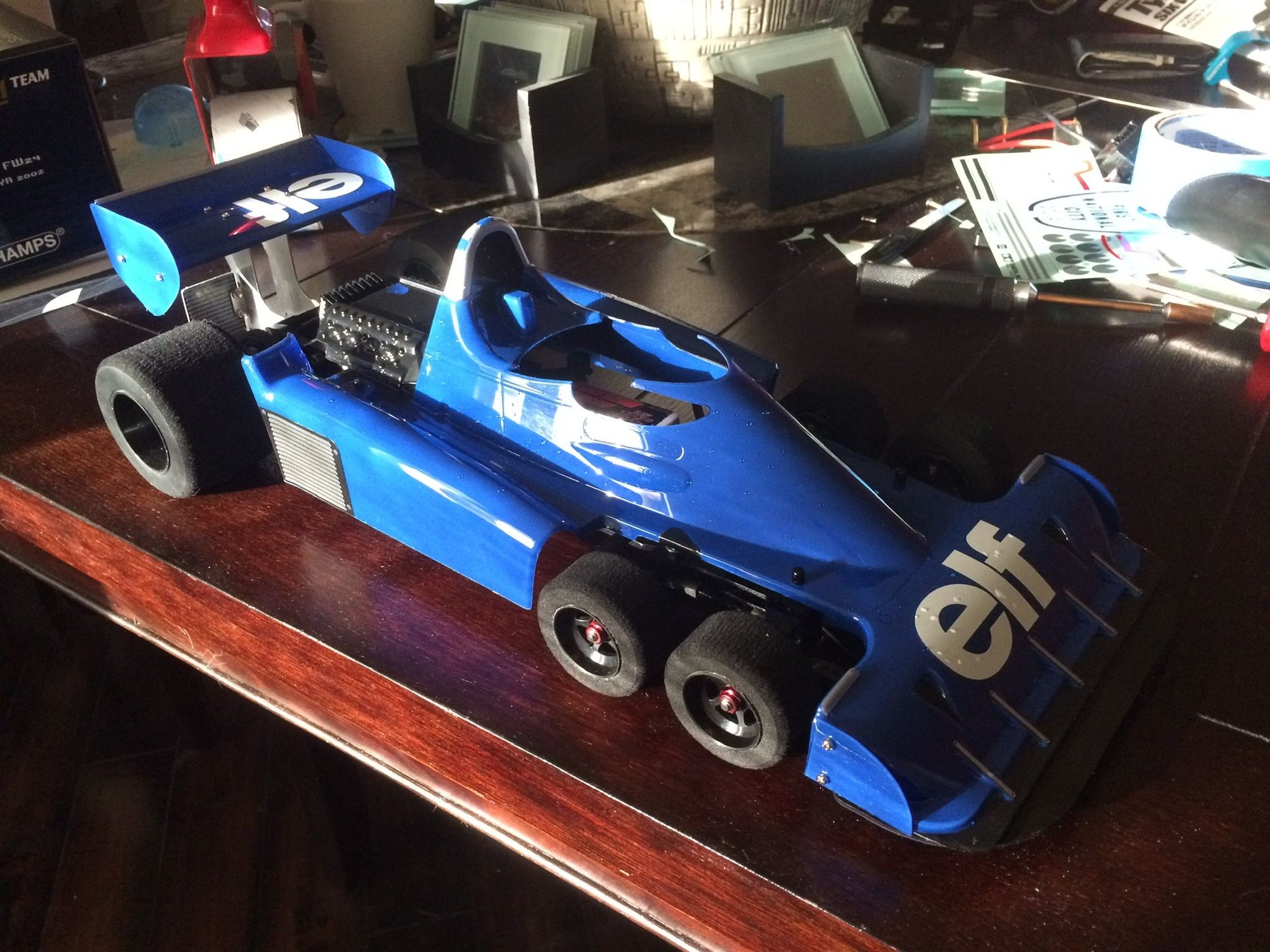

Has anyone tried putting the six wheeler P34 steering assembly on a F104? Or know how much part compatibility there is between the F103 and F104?

I think it is able to bolt right on. I think the servo mount holes might be in the same spot on the F103 and F104 front part of the chassis. I could be wrong though.
Now you've got me thinking I should have done that since I'm not fond of the F103 rear end. Almost done building my P34.

Might try test fit it since I have an f104x1 and a new p34

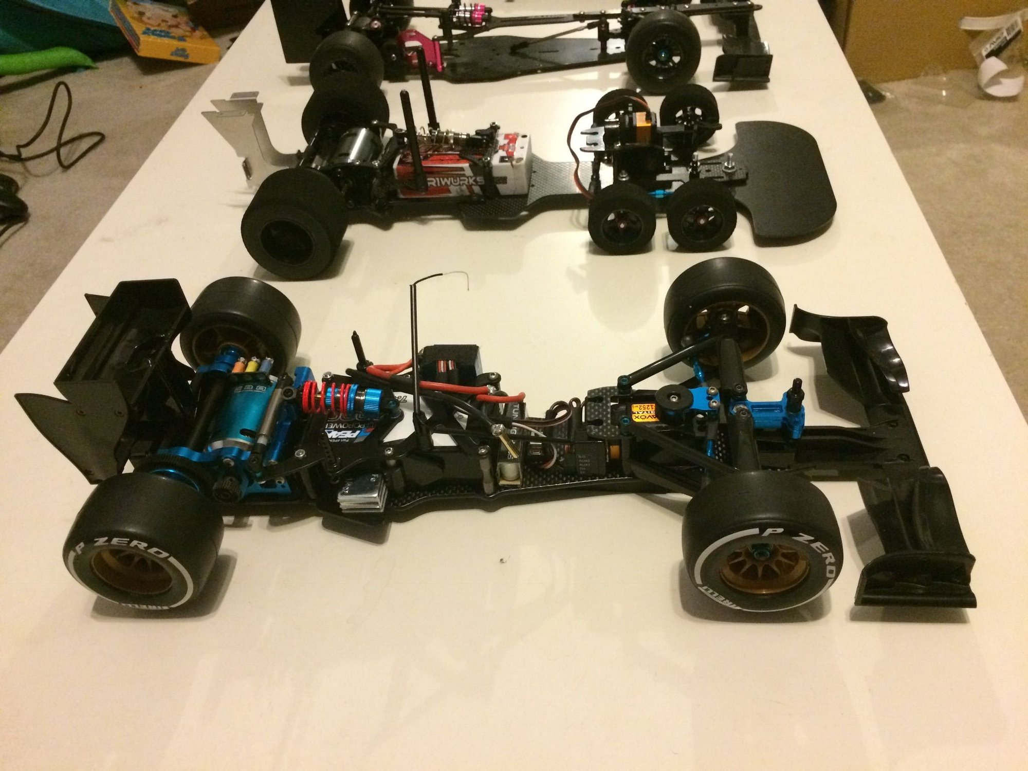

Its an older picture, but the chassis in the middle is the P34 front suspension on a F104 v2, although it should bolt directly on to any F104. The stand up servo even fits under the P34 body!

Very nice! Didn't even think about using the servo mounts and standing it up. I did not like the way the current setup mounts the servo for the P34 by just taping the servo flat on the chassis.

The F103 chassis plate has the same holes. You could even just use the F104 servo mounts on the 103 and be done. F104 rear axle for the fully enclosed diff adjustments and youd have an F103.5 six wheeler.

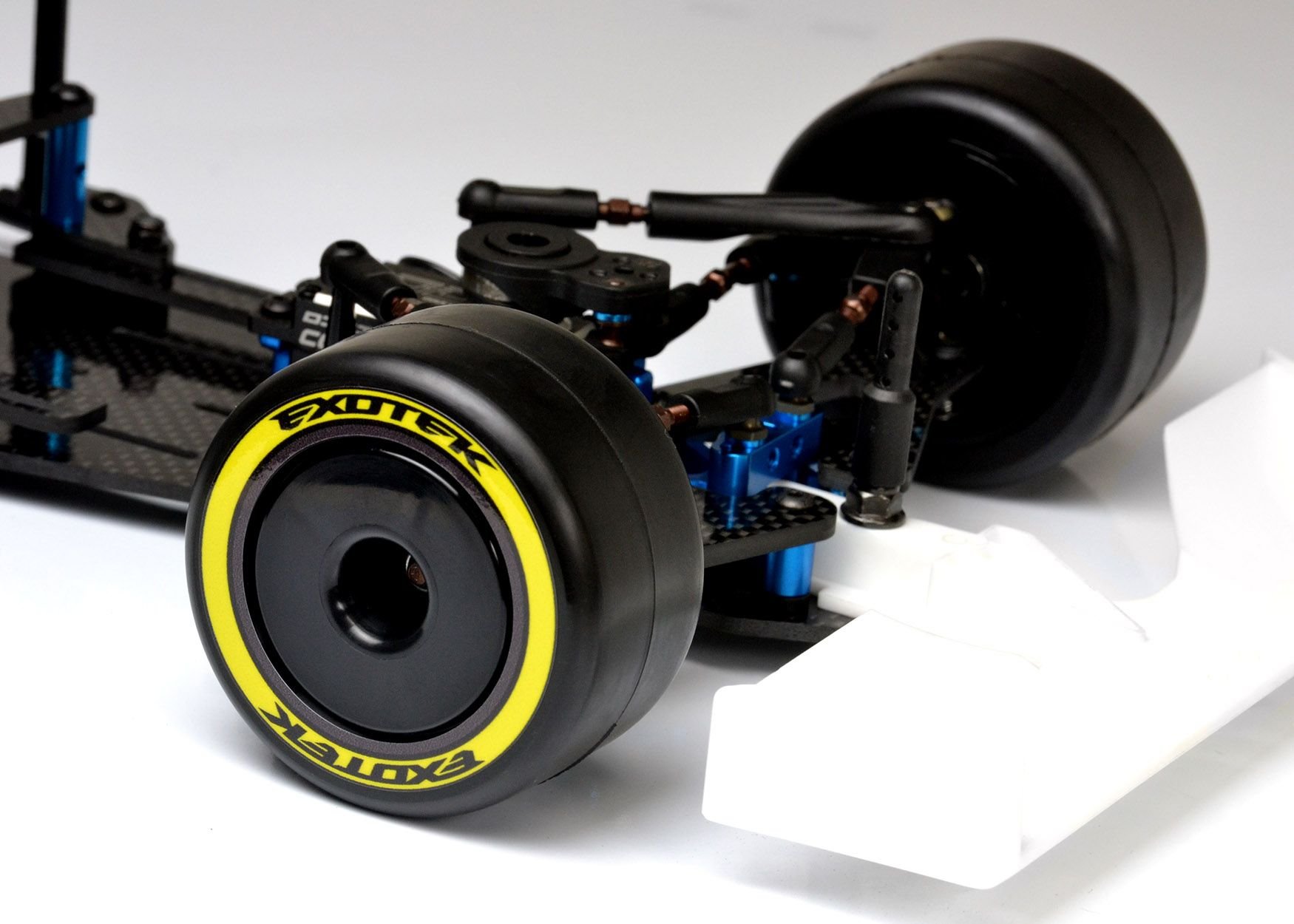

Exotek F1 Tires!

Nice, have they been tested on black carpet?

How much longer before they hit store shelves? They look nice. Is the wheel dish cover part of the wheel? And what dimensions are the tire? Hopefully similar to shimizu

Yes www.exotekracing.com

Yes but softer 33x compounds are coming in for carpet.

Does that mean the medium combo that's being released first, is best for asphalt?
