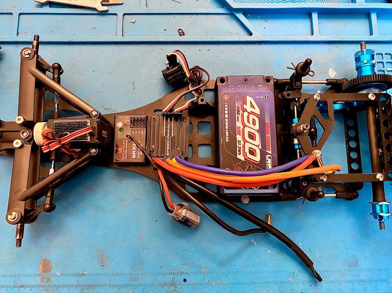

In setting up an F1 for asphalt, what is the preferred battery location. I have a choice between mid longitudinal or rear laterally. I have been running the battery in the lateral position, but have been experiencing too little traction in the corners causing oversteer. That could very well be tire, radio, or setup related, but I'd like to get thoughts on battery position. I was thinking it's possible it's transferring too much weight to the side in the lateral position? I suppose it's something to try out on a practice day, it's just a bit of a pain to relocate all of the electronics. As it is for longitudinal, I'm going to need to lengthen the motor wires and get a longer sensor cable.
Side springs are VBC soft (don't know actual value, only 3 levels, soft, med, hard) and the roll damper is a single hole piston with 80wt.I know the roll damper info doesn't mean much to most since it's more of a shock than a damper tube, but I'll at least throw that info out there. Front springs are silver Tamiya soft. Last set of tires I can were Volante Front med Blue/ Rear rev soft White, although I do have a set of purple med-hard fronts that I'd like to try. Sauced rears, nothing up front.
I also have a set of RiDE S2 soft front and S1 super soft rear tires.
Man, I need to clean that silicone mat.

For Cal RC and Revelations we normally run battery laterally and all the way back just like an off road buggy for more initial rear grip. I remember that shock being tiny and needing to go like 20wt on the oil. That should let the rear pod roll a bit more for the side bite. Volante blue fronts and white rears should be ok for now. Purples are very pushy for me. Bring it out to Cal RC, practice is this Sunday and will be very productive!

Thanks Mike, I stole the 25.5 out of it for my VTA car. Haven't found a replacement in budget just yet. Maybe I'll toss my 21.5 in it for testing. The roll damper shock is quite small. I was thinking it needed to be heavy since everyone runs very thick fluid on the damper tubes. I wish it was easier to change the oil. I do have some 20wt I could try. I'm going to try to make it out Sunday.

Damper tubes and shocks have very different properties. My car does not have damper tubes

Do a search for your car. It's a 3Racing F109, there's quite a big thread for it with lots of tuning tips.
