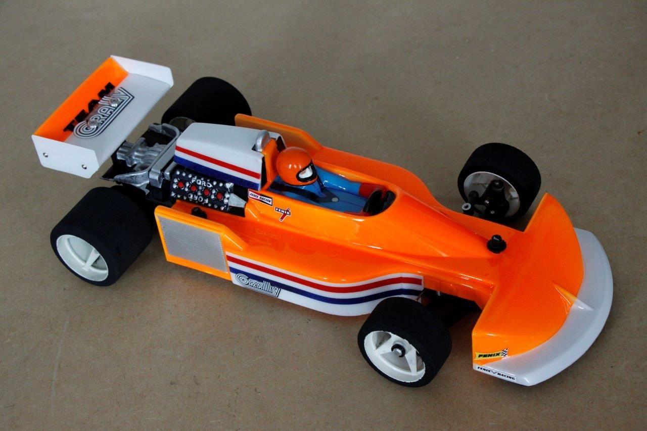

Just wanted to share a piece of history in our hobby

Posts: 149
Nice !
The old 1995 Corally is still a very good car. We showed that at some vintage races.
During the first lockdown I ordered some Fenix body's. They fit very nice on this chassis and behave very well during races. Give it a try !
