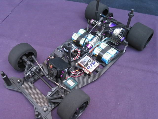

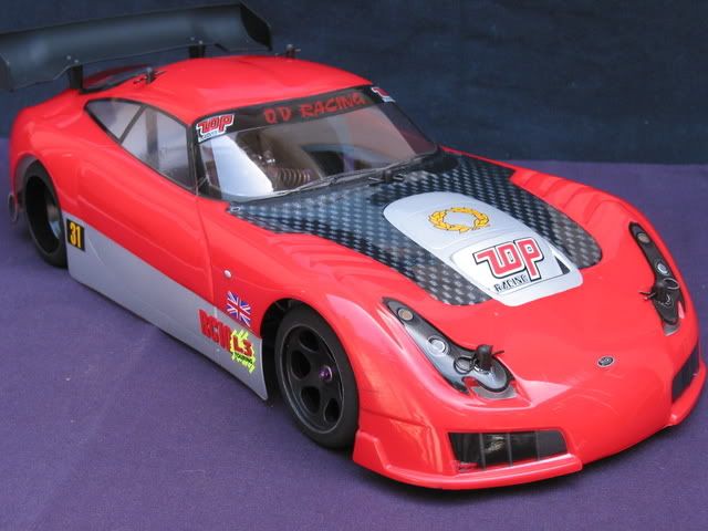

Here's my "new" 200mm Pan Car. Its built from an "old" AE 10L3T. I converted it from 190 to 200mm by using a wider right diff hub and spacing the front axles. Power is 4 cells with a 10.5 motor. The body is a TVR Sagaris by HPI

Clean and well done as always OD.
Good job.-Bruce

Am also converting a 10L3T to 200mm specs. How wide is the front end? What did you use to widen the front end?

It depends on what front tires you use. With the old TRC wheels I have been running the front track is about 190mm (the pic has the kit greens on as they are more photogenic LOL). The Lunsford front axles are spaced with just one of the AE white plastic wheel spacer washers, placed between the axle boss and the steering block.
