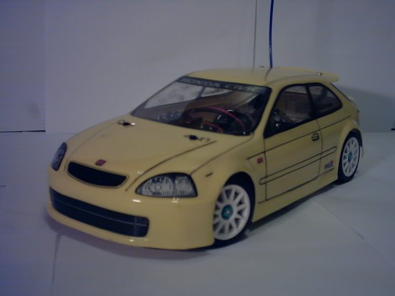

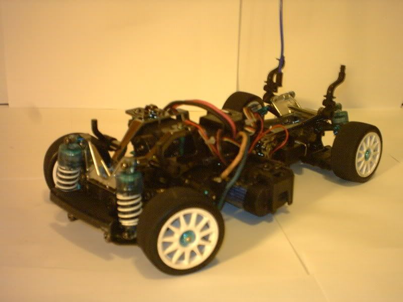

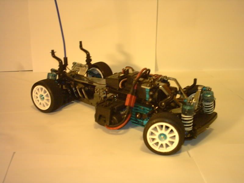

Thumbs up BRUSHLESS MINI
G'day All,
Here is a few photo's of my MO3M hybrid configured as a MO3R. I am currently experimenting with a Speed Passion Endless Exige Brushless system RS 540BL 1, which has the same top end as the Sport Tuned RS 540 motor. System is easy to install and setup.
Still use the 20 tooth pinion. Shocks fitted are the 3Racing with 45 Wt oil front and rear with STD springs front and Yokomo yellow at rear. No swaybars.
Needs to be setup harder to stop body roll. Fitting TRF shocks with white TRF short front and short TRF yellow to rear with 50 front/40 rear Wt oil.
Any questions let me know.
Later
Calvin.
