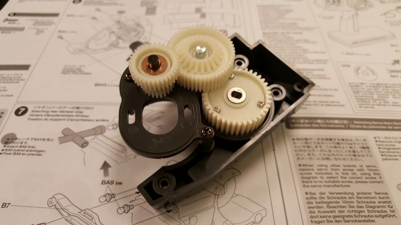

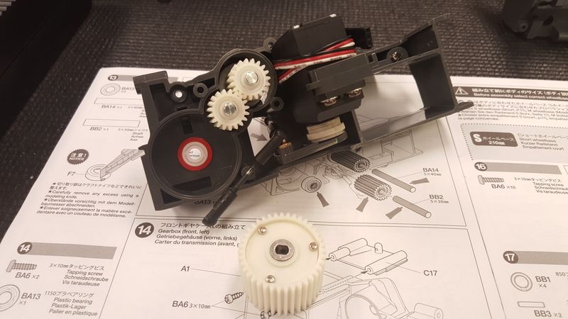

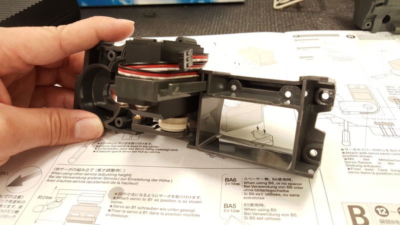

Originally Posted by EricP
Some pics of the MF-01x build
Hi, so the seal around the front gearbox looks very good. Is it the same at the rear? What is the biggest motor pinion U can use and what's the FDR? And I'm guessing TL01 gears means TL01 high speed gears to?

Stock TL01
19T - 7.96
21T - 7.20
23T - 6.57
Speed tuned gear TL01
19T - 5.95
21T - 5.39
23T - 4.92
